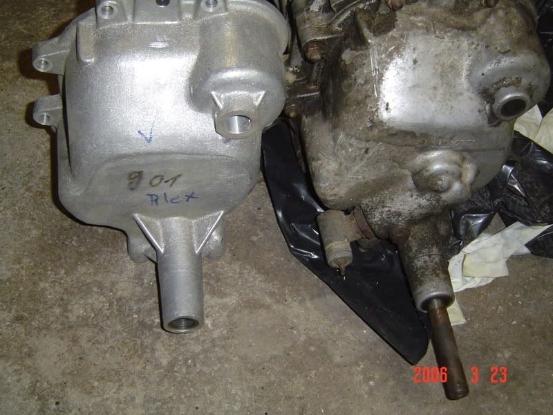

Bugat5speed June 28th 2007 07:37
# Jamesbissland,
...or simply order one of my 30 mm shorter nose cones. Have them for both types of gearbox (901 ols al. cast, or 911/01, 901/13 (all magnesium-cases) and 914. They are casted fot the conversion of Porsche 5 speed into Volkswagen.
You can not weld the mg-nose cones. If you want to shorten it, then youŽll have a problem.
See products on www.bugat5speed.de
contact me via info@bugat5speed.de, or contact Alex Olaverri in N.J. via bugat5speed@yahoo.com
Martin
Bug @ 5-Speed Germany

Bug@5speed(US) July 1st 2007 15:21
Here are some pics of the Bugat5speed parts.
VR
Nosecone comparission on early 901
Nosecone and front traverse
http://i78.photobucket.com/albums/j1...e.jpg~original
