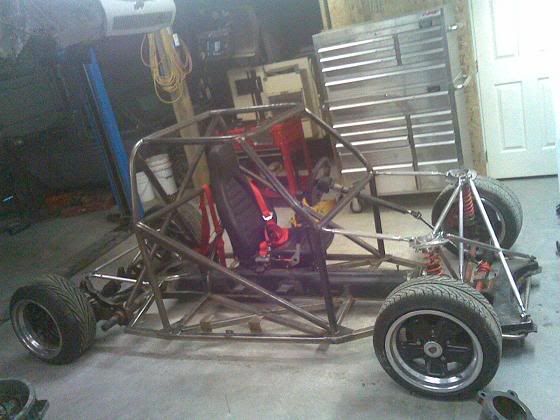

Check It out. Made some progress on the ole frame:)
Tig welding with the new Dynasty 300dx.
Some nice machining.
Now to take the body off and see if this can hold up the front supsension.:D
AirCooledNewBee October 23rd 2007 04:51
Nice work, what are you planning?
boratuner October 23rd 2007 18:11
That looks real nice. What are you planning for the final outcome to be?
vw1303 October 23rd 2007 19:53
The finished product will be a drift car that will be street legal. well kind of.:p
johnnyvee October 24th 2007 00:04
thats some hard core metal work, very sick :righton: very jealous of the strut bar

vw1303 November 14th 2007 16:39
Frame is finished. Now for the aluminum floor and brakes and some other goodies.:D

aircooled4life November 21st 2007 04:41
metal?
what type, size, and wall thickness are you using? (in the cage & the front and rear braces?) And have you added up all the extra weight/ weight difference between stock and how it is now? It is a really cool idea, I just want to know what kind of planning and calculations you did before you started welding.
Eric
vw1303 November 21st 2007 19:23
Alot of complex algorithms, fea analysis and alot of solid works.:lmao: if it breaks i'll build it stronger.:cool:
gsusmaniac November 26th 2007 14:47
So when can we get the specs on that custom front end? I would be very interested in taking the bug body out of the front suspension equasion!
flat November 26th 2007 21:18
FEA! You're giving me nighmares my days sitting in stress analysis class. Powerful stuff though....what software do you use?
