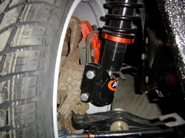

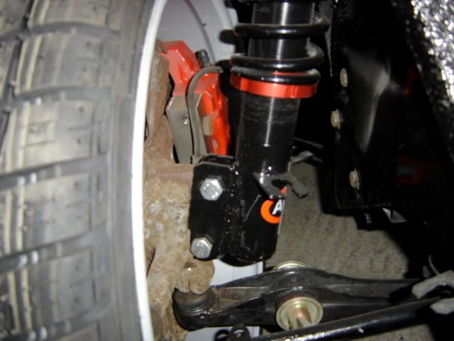

typ4boy June 23rd 2008 14:50
Here you go............ our late struts for late 944 spindles.............
http://i10.photobucket.com/albums/a1...8.jpg~original
http://i10.photobucket.com/albums/a1...9.jpg~original
