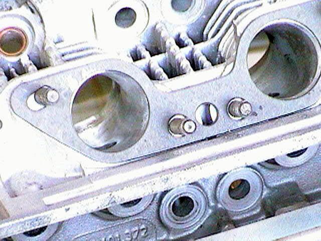

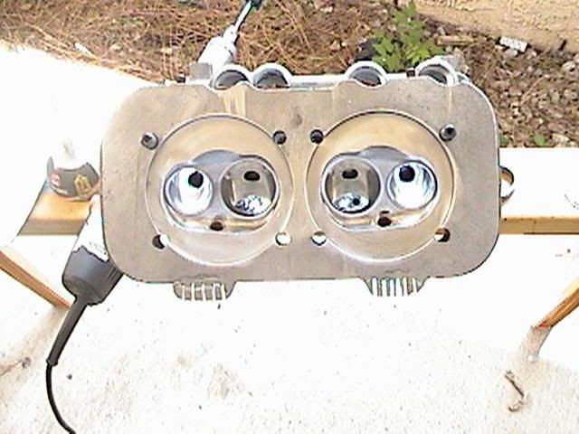

Hay Guys, I want very much to use the MegaSquirt system. I have a second type IV setup I would like to use the 1.7 intakes injection with. Although my throttle body will be from a 5.0. Saving some money on the EFI system sounds very nice. My heads are going to be totally re-worked hopefully to support a 2.7.
