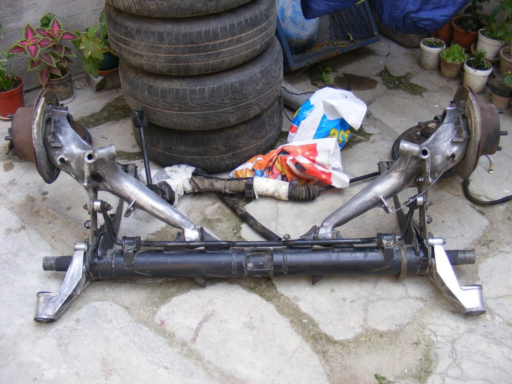

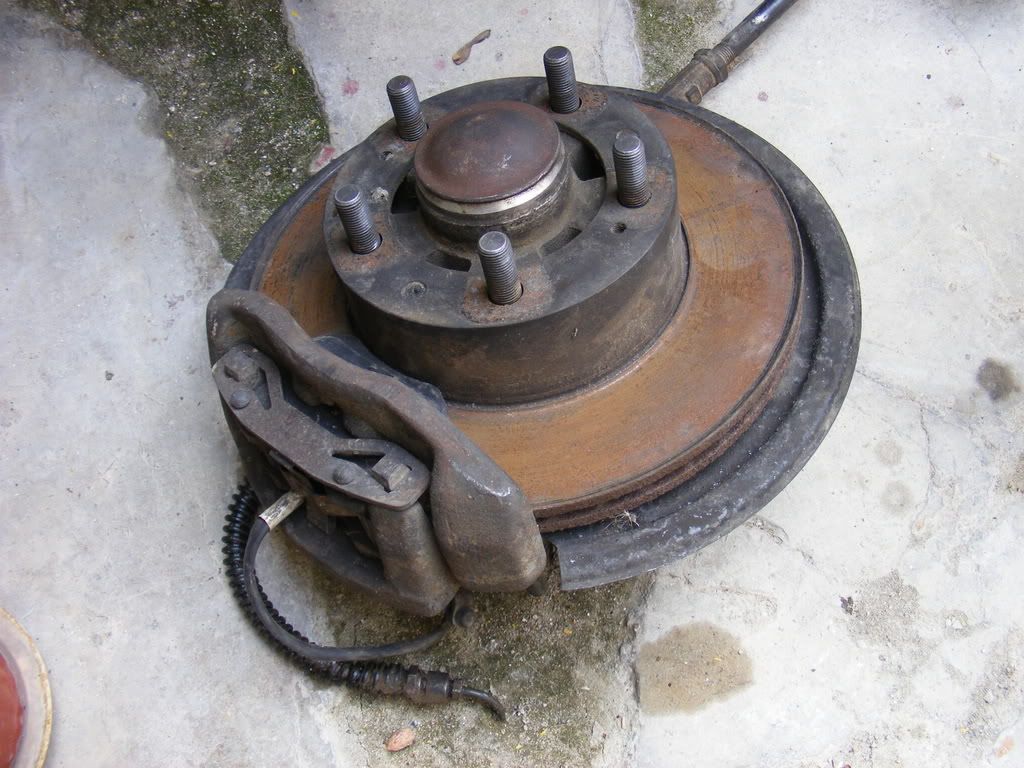

for the front get the complete spindles, as Superman said "everything from the strut out".
for the rear get the complete trailing arms, not only the brake parts. Also get the torsion bars, their spring plates, and get the anti-roll bar too.
It might be a good idea to get the drive shafts too.
The only thing you could end up not using in the pic is the torsion housing.
http://i260.photobucket.com/albums/i...1.jpg~original
http://i260.photobucket.com/albums/i...4.jpg~original
Oh, and get the brake master cylinder too.
