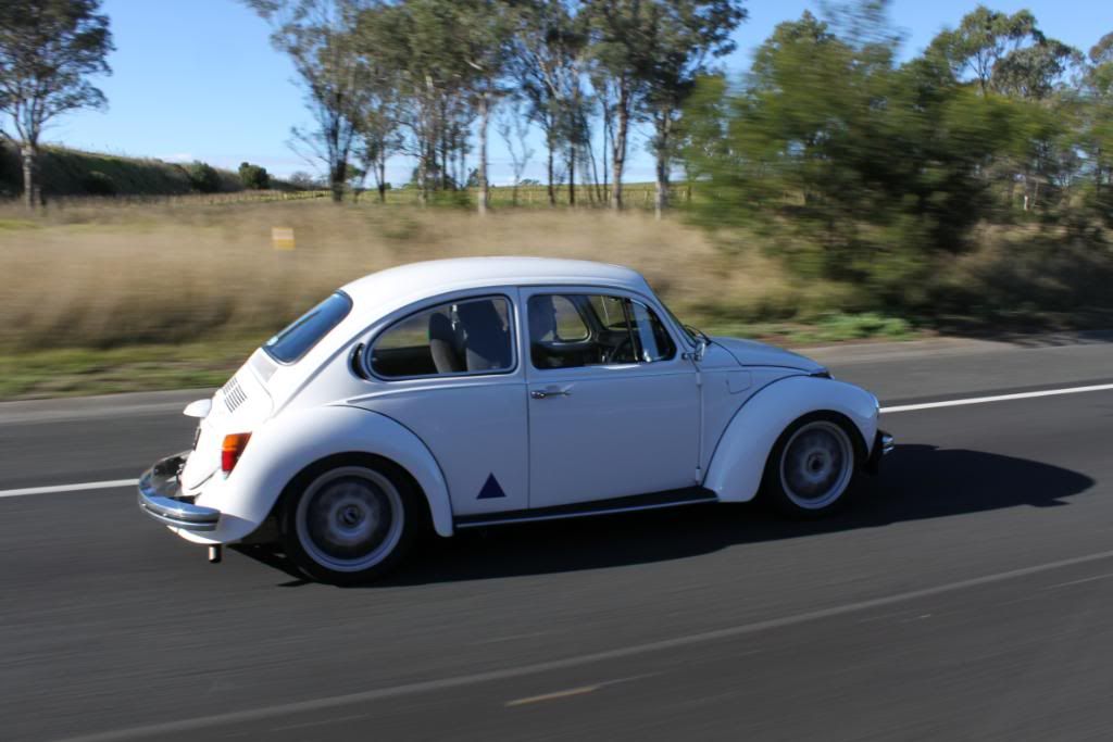

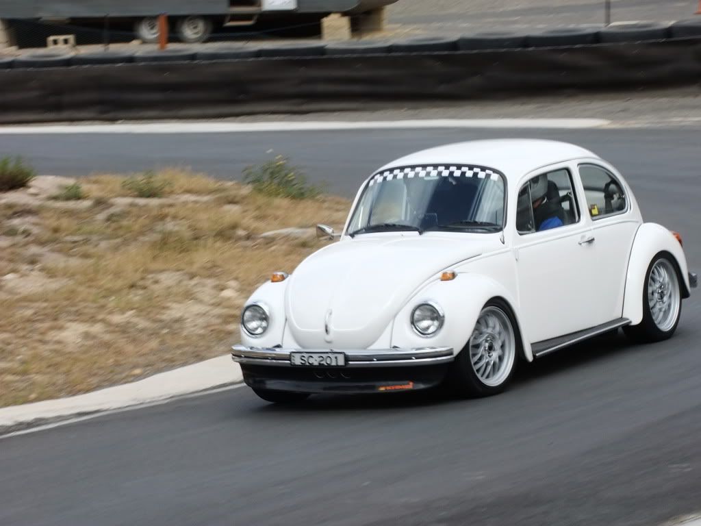

17x7 ET 55 (factory Subaru BBS), on a 2 bolt 1303. Front fit nice with narrow coils, rear needed to go steel 944 arms & brakes, fit really well.
http://i1184.photobucket.com/albums/...0.jpg~original
http://i1184.photobucket.com/albums/...n.jpg~original
flat November 15th 2008 23:27
Steve, Looks killer. You remachined the rear 944 brakes for 5-100? What brakes in the front?
Steve C November 16th 2008 04:44
Hi Lanner
Thanks, it is 5x100 now. This is my sometimes daily driver and sons 1st car until I finish my other 1303.
I was able to score for the rear a pair of twin piston alloy Brembos from a later 911, these have 42mm pistons. On the front I'm using stock bug rotors with early Type 3 calipers, these also have 42 mm pistons. Its very slightly biased to the rear, I'm fitting a bias valve soon.
