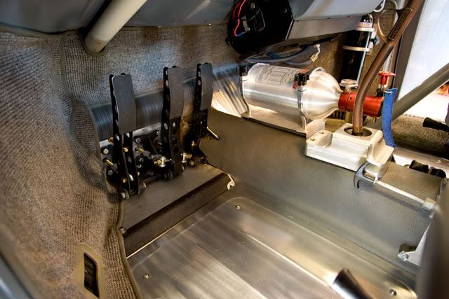

This is how we took care of that problem on the Herbie X. It is an expencive setup and tok a while to get it installed. But the owner thinks it was the best mod we did to the car (and we moded everything).
It is a Tilton 600 3 pedal set-up. It totaly changed the way the car feels to drive.

Hey Dave, what did you guys end up doing to mount the pedal assembly? I talked with you over the phone but I never got to see the finished results. The tilton 600 (and similar assemblies) are by far my favorite and I can't wait to get mine in the new chassis.
NO_H2O April 27th 2009 20:34
If you can see in the pic, we raised the flood with .080 2024 t-3 and some spacers on the mounting bolts. The rods were extended thru the bulkhead (holes cut and spacers inserted) the M/C's are on the forward side of the bulkhead. a flat sheet of .100 2024 t-3 is on the bottom side of the pan. Bolts thru all layers stiffen things up nicely. It took a while to get it all in the way we wanted to but the end result made the owner very happy. The Tilton techs got the M/C size selection right on the money. We put the bias bar right in the middle and tested it in the parking lot of the owners building and never touched it again.
I want a set in my car some day.
