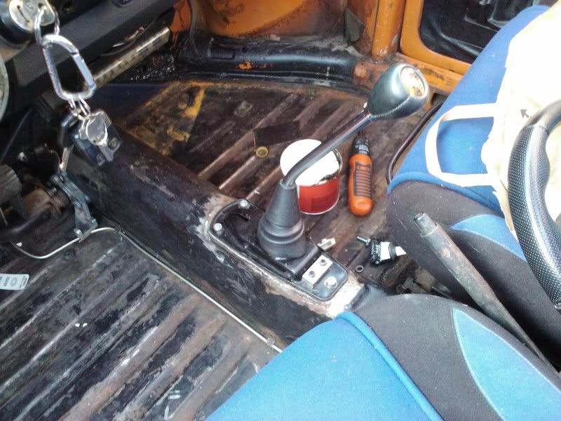

hears some pics of the 911 shifter mod

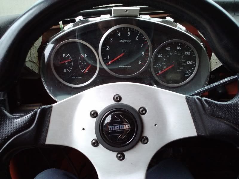

setting up the dash to run 05 wrx gauge cluster

Into it... Can you tell me where you got that really nice base for your shifter?

The base for the shifter was the center section from a 914 found a wreck one and cut it out and trimed it down.

I love the wrx dash cluster!

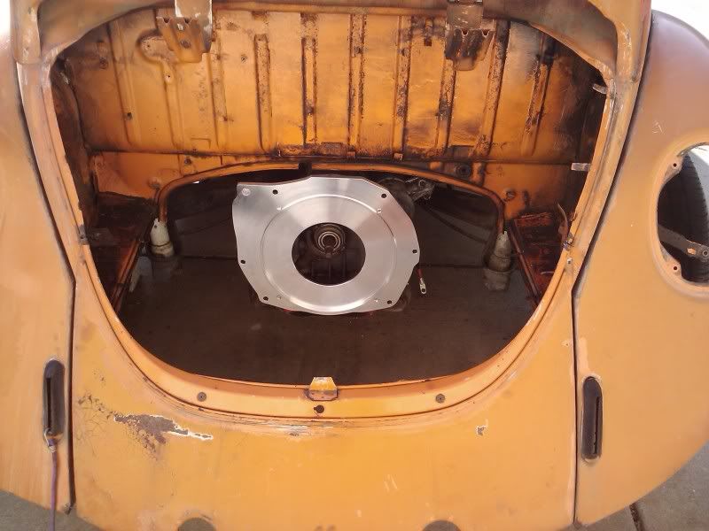

my kennedy adapter plate going to do some test fitting this weekend if the weather holds out to see how much i will need to move the transmission or cut the body

the adapter plate faces the otherway around
spin it so that side is facing the trans

good call buggin havent had much time to mess with the adapter yet so thats good to know
