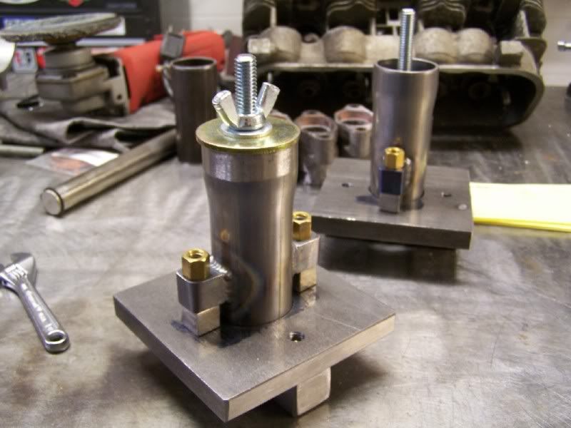

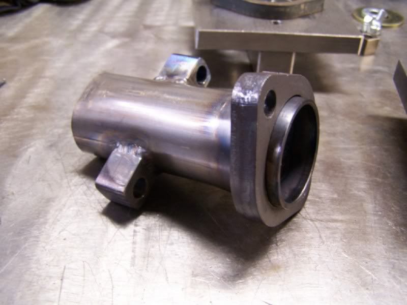

I finally got around to making my stub pipes. These are made out of 1 1/2" .095 wall DOM tubing with 3/8" flanges, and the tabs are 5/8".

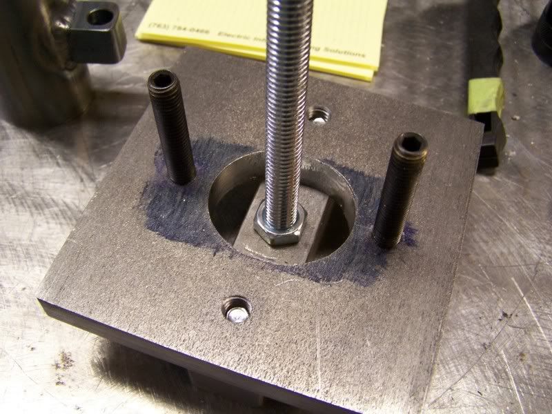

I made a jig to weld everything together out of 3/8" plate so nothing would move when heated up. It works for locating tabs, and then for flanges.
Here's a few pix of the process...

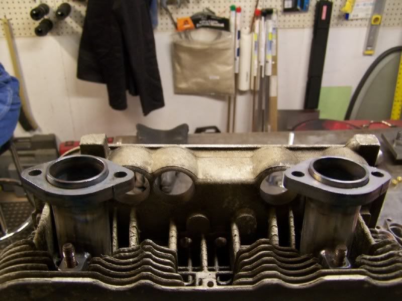

This is a mock up head for testing. They drop right on!

very nice work, do you try it with the push rod tubes and check for rubbing

Very nice work indeed! You put in a lot of effort for this, respect!
Nice welds too!

stunning work! very good workmanship

Brujo65, The tubing is 1 1/2" flared to 1 5/8" with a tool I made on the lathe. The only tube that touches is the exhaust push rod tube on #1 and #4 cylinders. They don't touch very much with a stock tube I had laying around, but the tubes on the real motor were already "modified" when I built the motor at Jake's

Very nice! I thought about doing larger flanges (like CSP) for better bolt clearance, but wanted to keep it a "standard" size. The jig will help keep everything were it should be from the heat of welding. Give your friend a "practice part" to see if he can do it or not. Welding thick to thin material can be tricky for the novice. I like to help everyone out in some way... posting "how to do it" is one of them.

Xellex, did you notice Wrenchnride used 2 jigs for this?
IIRC, the type 4 head has the studs slightly off-centre and two are on the other side of the 'oval-flange-centerline', hence you might need two sets of different jigs for this.
Correct me if I'am wrong here as to the reason you use two jigs Wrench? (sorry, forgot your real name mate)

Now that could be a problem! I only thought he used 2 jigs in order to work faster and not flip the studs every time.
I did alot of measurements of the exhaust ports in the cylinder heads, but it's pretty hard to fit a caliper in there and get a perfect reading. Also the studs can be old and bent, and you can't get a good centerline. I haven't found the exact measurements anywhere on the web.. Actually what I did was to measure 4 different heads (8ports) and take an average of those measurements.
What I thought of, as a solution to slightly misaligned parts, is a bit larger stud holes in the 2 small brackets/tabs that get welded to the pipe.

Wally is correct. I thought it was common knowledge there are two stud patterns per head. Sorry . I used factory cast stubs I cut off some old heat exchangers to pattern my hole locations on the jigs. If you make the holes on the mounting tabs for the studs to go through too large you risk exhaust leaks from heating and cooling cycles. Can take a pic of the difference between the two if needed.
