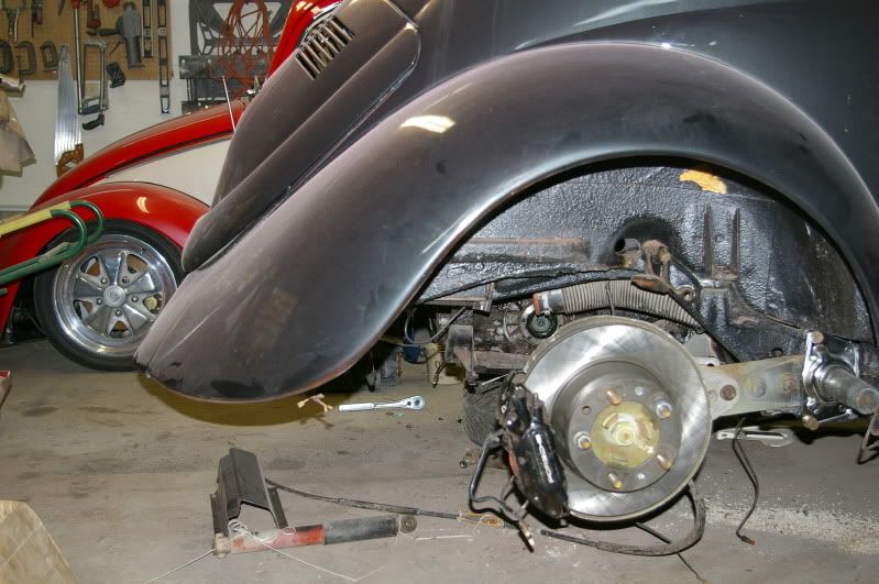

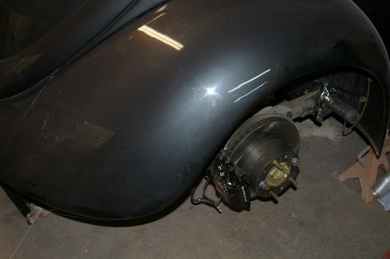

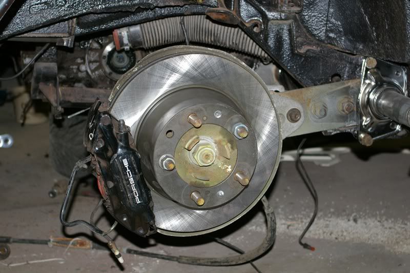

All parts are now installed and it looks like I will have to run the 3mm spacers to center the caliper. Mock up is finished. Time to pull it apart, blast and powder coat.
