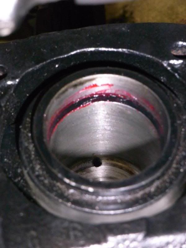

My cylinders were honed and the pistons cleaned and oiled. Bodies were stripped and painted in Smoothrite and the bleed and feed cleared out before starting the assembly. (thanks Dad!)

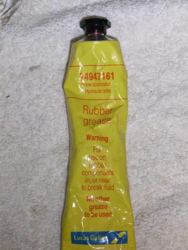

You'll need a caliper rebuild kit (rear kit shown), some brake fluid and optionally rubber grease

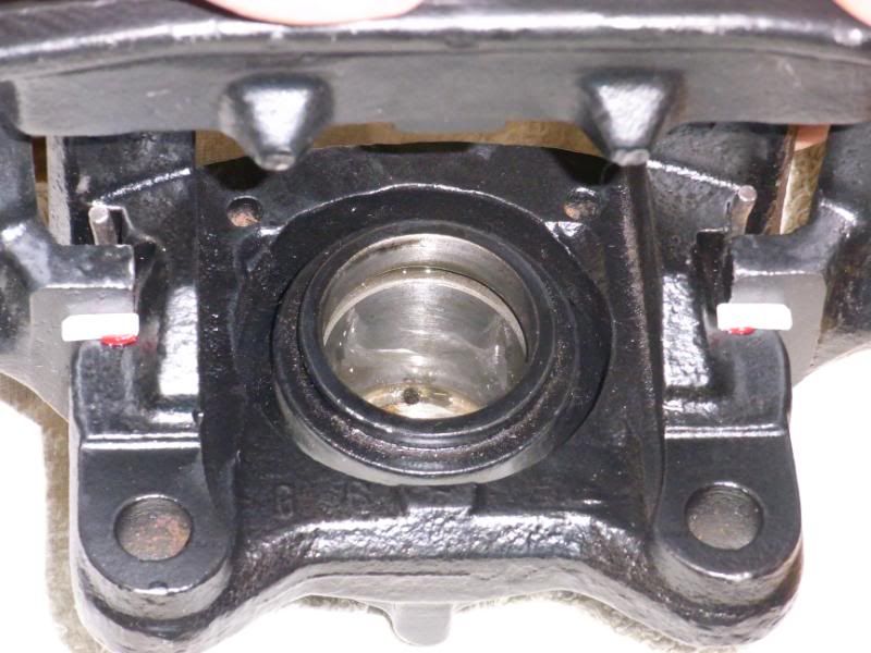

Fit the pots into the carriers, they are a friction fit. Best method is get them started and then knock the assembly on some old carpet on the floor with your weight on the pot to drive it home. Remember that the bleed nipple in every instance goes on the curved side (top) of the carrier.
A later picture but it shows how it is oriented (rear pictured).

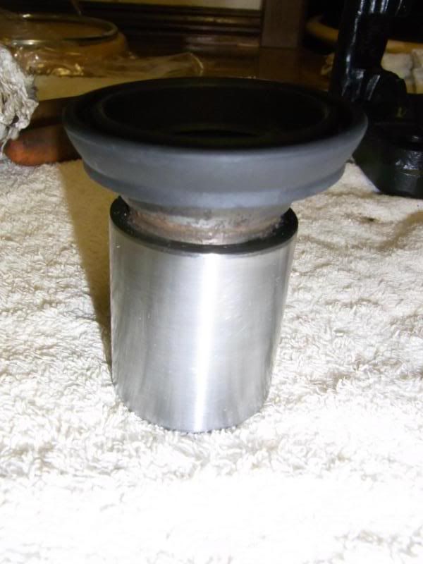

Fit the dust seal to the piston

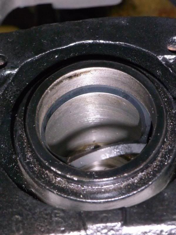

Then get the straight seal into the bore and straight in
Rub some brake fluid all over the bore and the piston surfaces to ensure full coverage, this will also stop any rust forming if they are being stored before using. I smeared some rubber grease on here to help the piston ease in

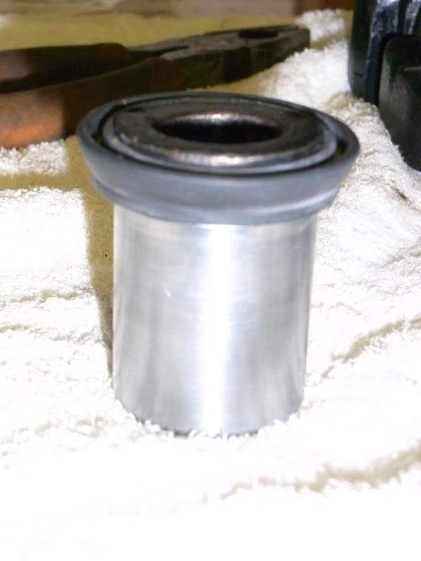

Get the piston in straight and push it home, it'll be tight but that's a good thing.
Then pull the dust seal over the body of the pot...
And fit the split ring to retain

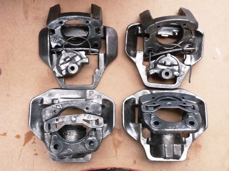

That is job done for the fronts, the rears are slightly different, check the photo at the beginning of the thread. For these you have to install slides and assemble both parts together.

Get the calliper upside down as shown, the springs need to line up, you'll see where if you're doing them
Taxing at best, but you need to push down on the other part of the calliper while pushing it over the slides and keeping them in place. You'll end up with them looking like this
Job done.

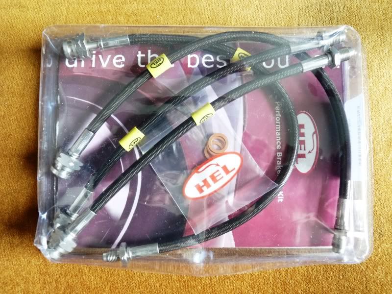

All ready for these stainless overbraided hoses
