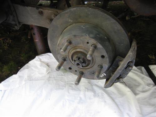

Here is the 84NA brakes in place on the IRS suspension:-

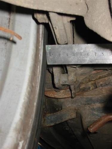

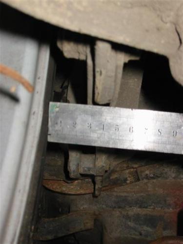

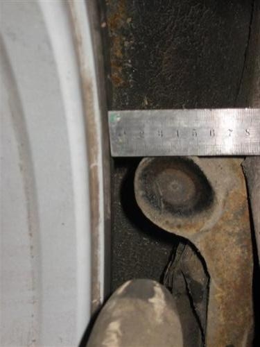

First up the 7.5' wheel. This is the springplate clearance, about 28mm gap between the wheel and the springplate

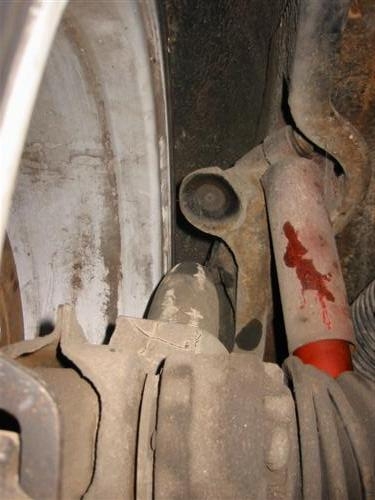

Again with the 7.5' here is the bump stop clearance, about 15mm

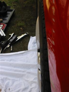

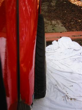

Lastly with the 7.5' here is the side profile against the body. I think it might just fit under the guard if I put it back on the ground:-
Now with the wheel I intend to put on the rear, the 8.5' ET55. This is the springplate clearance which is about 15mm
With the 8.5' wheel the bump stop clearance is only about 1mm. I think I might need a spacer to bring the wheel out a not more. Any idea how much I need to bring it out?
Lastly here is the body profile. I'm thinking of putting 4cm wider fenders(US)/guards(AUS)/wings(GB) on there. Do you think the wheel will fit under?

1st its not bad to mix breaks te most breaking power is in the front. and 2nd the clearance must be about 2cm. Depends on the size tire.
