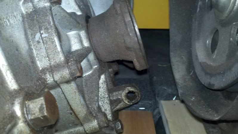

Hay, the 901 that I have has a bowden tube holder, but Bug at 5 speed post states it won't work well. It looks pretty stright forward, I'm trying to install this trans on the cheap. Although cheap, not cheap and stupid. I would like to have the origianl stick shifter work, and this has nothing to do with cheap; I just want when someone looks inside they only see a stock shifter.
Is this trans hard to mod? I see that the vent hole is already on the correct side and positioned correctly.
Why does the shifter rod have to be bent into a "Z", it look like it would not take that much to couple them. I see where Bug at 5 speed moves between the 914 and the 901, its kind of confusing; such as if the trans has the correct nose cone already, why change it. It is just for the 30mm savings

1. The bowden tube port from the 901 wont work - get the Bug@5spd Tube Adapter. (the bowden and it working correctly are very important to a happy shifting / non-bucking trans)

Sorry it took me so long to jump in on this. Having just installed a 901 Transmission this winter on the cheap, I think I understand where you're coming from and what you're looking to accomplish. Reading through my build thread and all the photos would definitely help you out.
1) Bowden Tube - My transmission had the same holder, and I used it without any problems. Most of the build threads or install stuff you'll find online say to cut it off and build or buy a custom mount. I've instead lathed up a bowden-tube extender that goes on the tunnel (front) end of the bowden tube:
The eyelet cast into your transmission will need to be opened up just a touch, I used some emery paper on the inside of the eyelet and the outside of my bowden tube until it slid together.
Keep in mind that the clutch cable length will need to be determined by your own personal setup. Where you place your transmission, and how you do your bowden tube will change the required cable length. On my '73 pan, with the transmission mounted forward so the engine sits exactly where it would with the VW trans, I'm using the shortest cable I could buy ('52 split beetle if I remember correctly). This was shorter then anything suggested in the online tutorials, but most likely due to the way I pushed my trans so far forward.
Thank you very much, I plan to relocate the bowden tube much lower, hope to start this weekend after I buy trans mounts.
