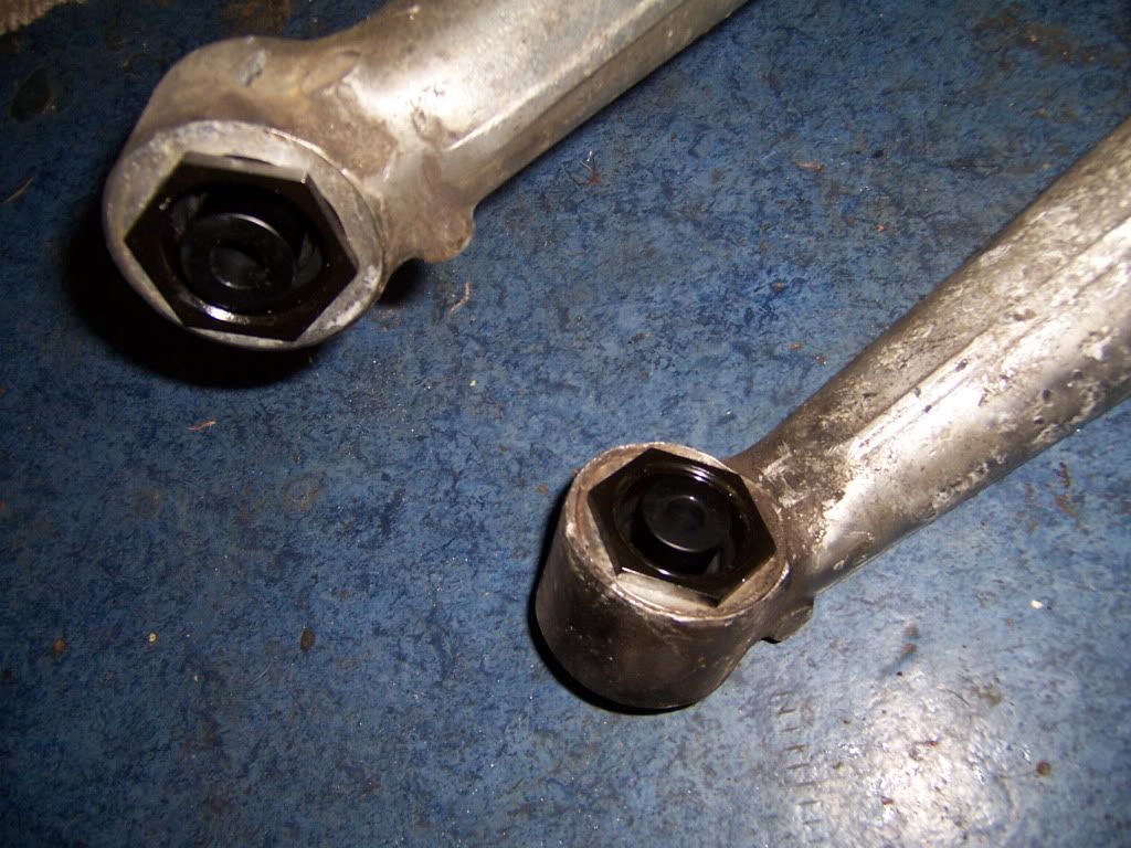

Received the uniball bushings and the polybronze ones today
They fit VERY nicely and precise!
I think I will try to fit the inside polybronze bushes as well as the inner circle of the 944 and bug torsion tube housing look to be the same.

also, it looks like the hole through the trailing arm bushes is too small. Are you using the stock beetle bolt, or the porsche (thinner) one?

well, you know how the beetle trailing arm bolt has a bigger diameter than the porsche one, and that you need to pull out the porsche bushings and replace them with the beetle ones, to make that bolt fit through.
Now, from your pictures, that hole looks to be too small to use the beetle bolt. That's why I was wondering, if you made some modification to your chassis, to be able to use the porsche bolts
Ah, yes, now I understand what your saying: yes, I did convert to the 12mm Porsche 944 bolt by welding in 12mm nut(s) deep within the forks
