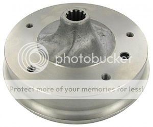

Would it be possible to re-drill the rear drums to Porsche pattern?

No, because of the casting in the center of the bus drum that will interfere with the Porsche wheel:
