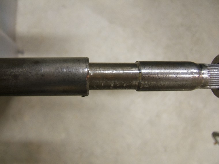

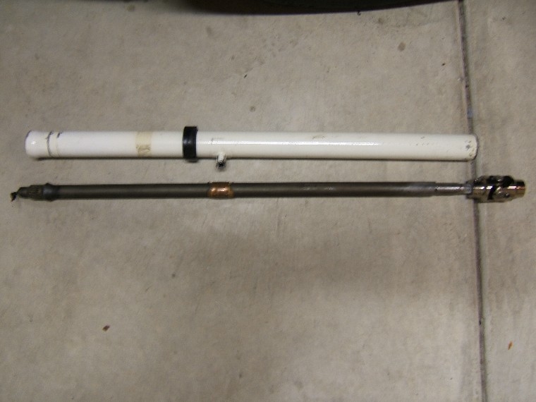

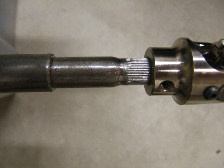

Here's the steering shaft. The stock outer housing has been shortened and will need to be shortened some more, and the main steering shaft has been shortened as well. It will have the intermediate piece slipped inside it and welded. Residing inside the housing is a machined Delron(if I remember correctly) bushing that limits lateral movement of the steering shaft. A new bushing will be machined and pressed into the end of the housing to rub up against the Ujoint to limit in/out play of the steering wheel. Don't tell anyone, but the Ujoint is AMERICAN!!! Its a Flaming River hot rod one, but I could only find a guy that made standard splines on shafts, no metric. Ever try to find someone that makes splines? If you want to spend LOTs of time, give it a try someday.

The steering is now complete. I'll get pictures soon. I had to enlarge the hole for the steering shaft at the front bulkhead by about double towards the midline to accomodate the steering shaft angle dictated by the rack location.
A friend of mine machined a spacer for the end of the steering column to resist in/out sliding of the steering shaft. It inserts into the end of the steering column and rides on the edge of the Flaming River U-joint.
It should work out really well, but it uses the stock 1960 steering wheel. It's very "sleeper" but I'm afraid I'm going to have to do it all over again with something I can use the Porsche 996 Tiptronic steering wheel on.
