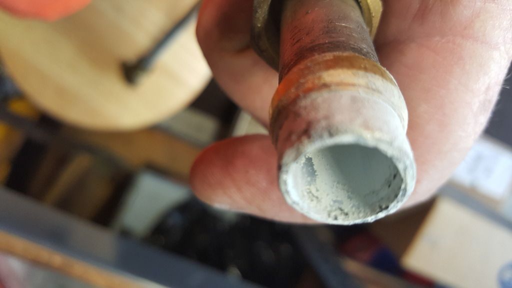

For those of you that warned me about using aluminum for fuel lines with a alcohol based fuel -- -- Well,,,, You were more than right
My injectors looked the same too!!!!!!
