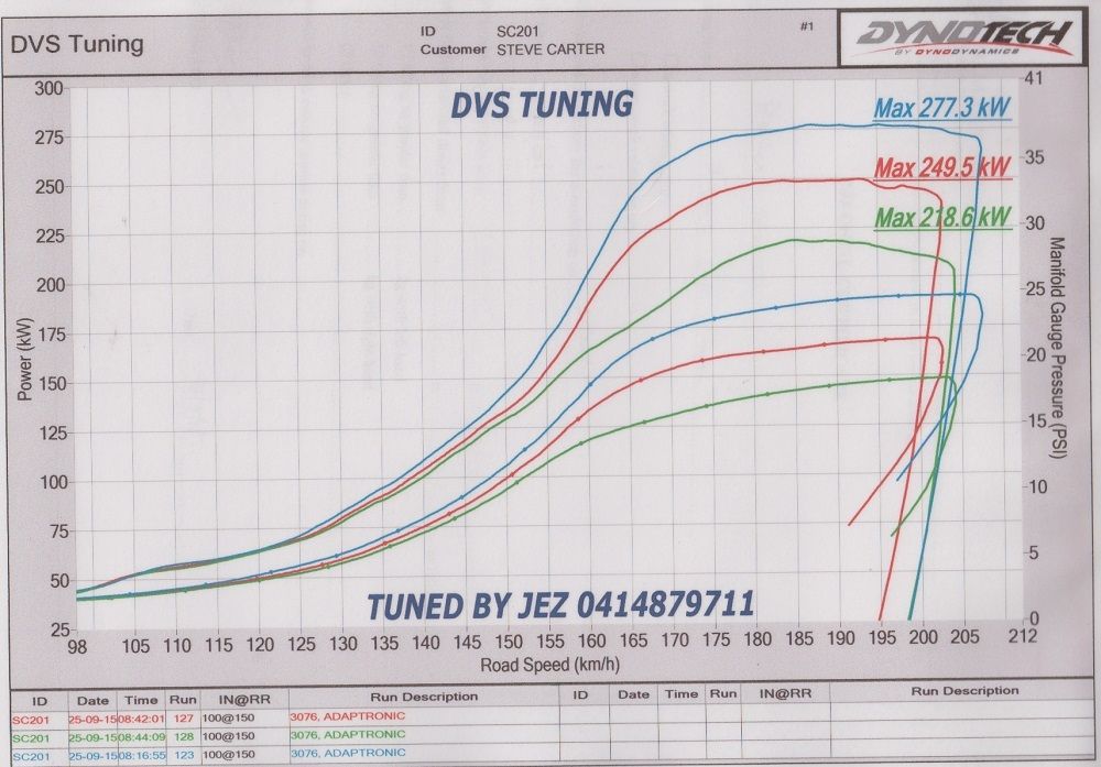

Gone from 229 kW to 277 kW.
I've fitted Tomei Pon cams, Adaptronic 1280 ecu with E85 flex tune (it can run normal 98 RON unleaded), LS2 truck coils, larger up pipe, so its now making 277 kW, cant wait to drive it in anger, VW only 1/8 drag meet coming up in October.
The MAP sensor died on the dyno last night, so a 2 hour train trip home, borrowed a MAP sensor from my sons drift car, drove the tow Prado up with a trailer on and the tune was finished this morning.
I've done three road trips on E85 so far no worries getting it.
