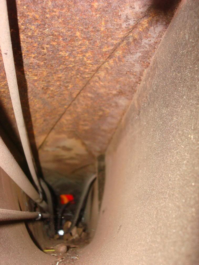

Here are some pics of my bad luck.. Here in the NE of USA (NJ) its hard to find any thing decent.. and I don't have the time due to son and work to go out west or south, unless I got some trustworthy help.. I am all ears if someone has ideas.. So here is my misfortune.. I put some primer to protect it, but you should be able to see the damage and porocity due poor welding.. (HELP )
I would hate to destroy another bug to fix this one, but again I am open minded for the time being.. Any leads, info or thoughts are welcome..
Passenger Side tunnel
Driver side tunnel
Pan Head
One side of Pan
Inside tunnel: Not sure how that piece of flat stock is being used, but don't like it..
Misaligned lower pan head to napolean head

1) First, the chassis above, now has no panhead, after spending many weeks cutting and thinking how to patch this thing up, finally decided to chop it off and see what other mischief the previous owner did. Well to my luck, it was worst than I expected, very poor job on the chassis, and would have potentially been fatal to the car and myself. Very dangerous. Lesson's Learned. I have found a race shop out in PA, that will weld properly a new pan head, so I will save some labor hours and prep my old chassis and see where that takes me. I tried finding a chassis in decent shape locally but it has been tough, and when I do find them they end up being from Ca, but haven't quite figured out how to ship it...
Here are a few pics of the pan head removed, and shots from inside the tunnel from the old chassis.
