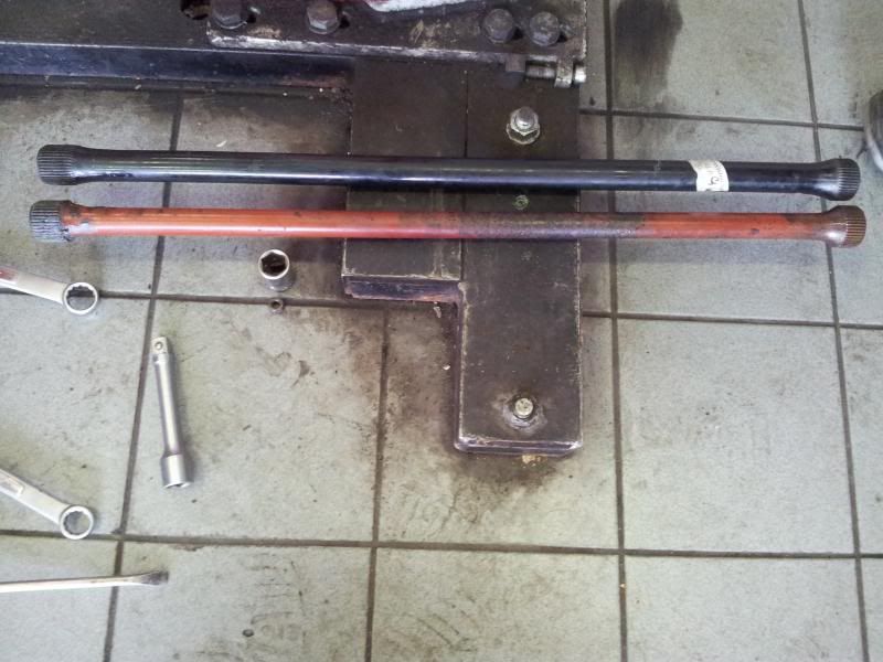

I managed to find a set of 25.5mm torsion bars from a 944 M030, I hope they will be fine with the "heavy" type4 in the back.

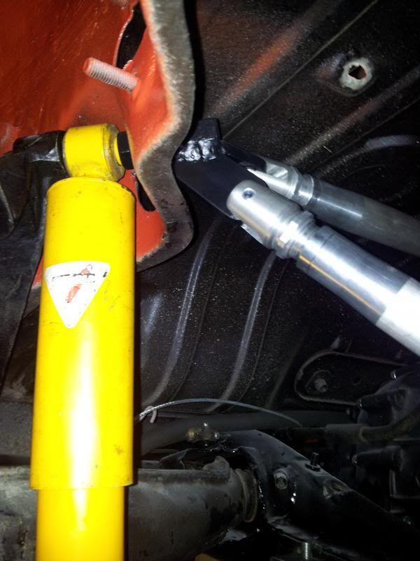

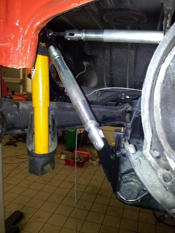

Installed the cup brace as well. 3 braces weight 1 kg together, while the 6 little ears weight nearly 2 kgs! Due to weight reduction and aestetichs the ears were cut a bit.
Fits nice with the Rancho:

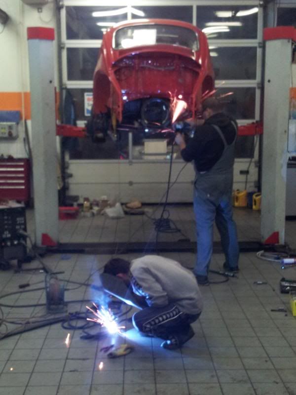

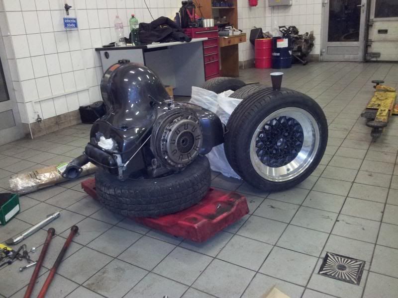

However the Rancho unit is already machined to accept a bigger flywheel, the 228mm is still too big, so we had no choice...it is still not OK, when all the screws are tightened the engine won't turn around next time I'll figure it out.
Friends are welding and grinding
Coffee break
Result of the day
