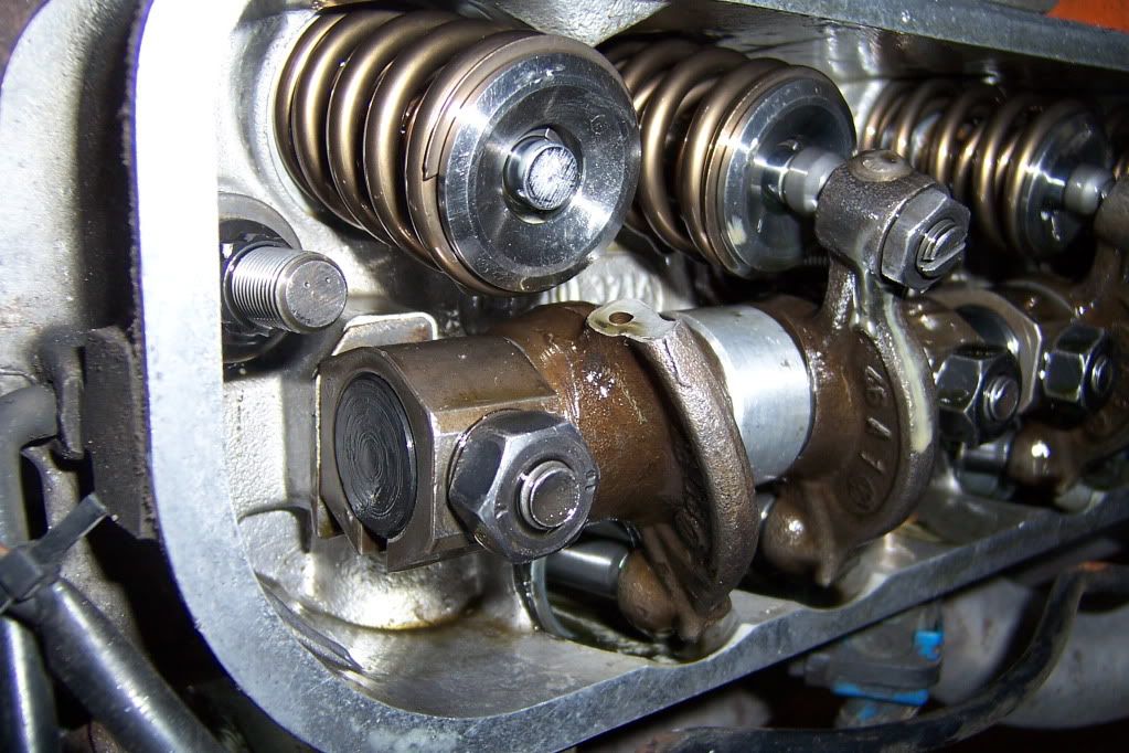

This is what happens if you run into the 'hard-cut' rev limiter:
Some of you may recognise this phenomenon from my previous encounter with the hard-cut; yes, this already happenend before...
This time I wanted to test flat-foot-shifting, so soft-cut was lowered a lot and hard-cut set at the same rpm distance from the soft-cut, about 600 rpm.
This will never happen again now, as I will now set the hard-cut 2000 rpm or more away from the soft-cut. The cure is apperently worse then the problem it tries to prevent...

Posts: 1,795
Ouch.
I hope that rocker was the only component damaged, and nothing else was hurt.
Was this the same exhaust rocker (same valve) where the break happened previously ?
  #808
Old May 15th 2011, 09:44
Originally Posted by Sandeep View Post
Ouch.
Mee too, I very much think nothing else was hurt, but not verified yet.
Can't remember, it is the same bank though, but that question suggests something that isn't there imo. The cause is violent rpm-cut, it could have happend at either cylinder imo.

Damn, again? What kind of pushrods are you running and how long were you on the hardcut? I've spent a few seconds on the hard cut (500 rpm between soft @7500 and hard @8000) on longer straights so I'll have to watch that
