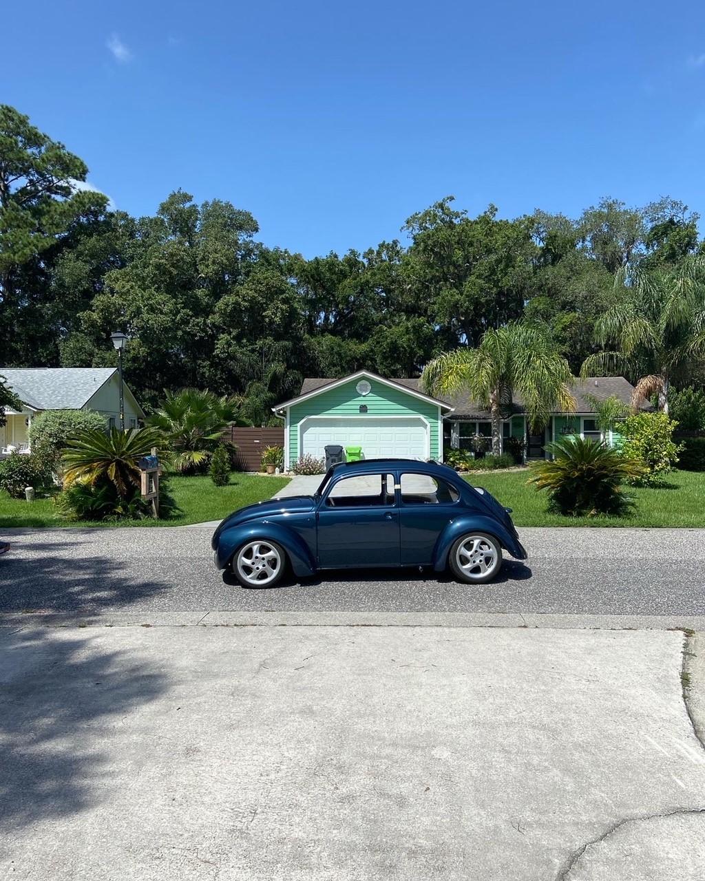

The Photos below is the day we brought "Dumps" home. My daughter named it that day.
and the most current photo....

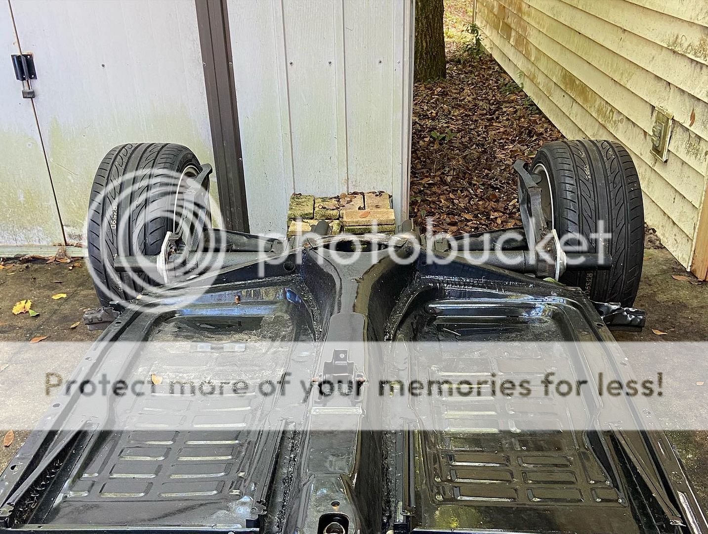

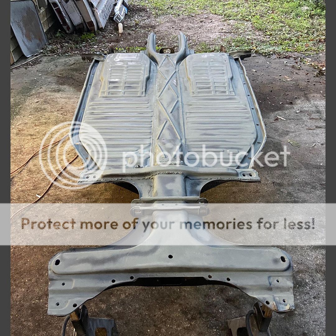

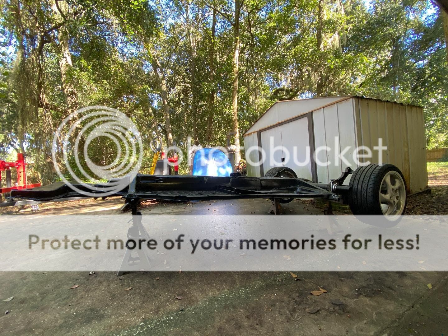

Pans

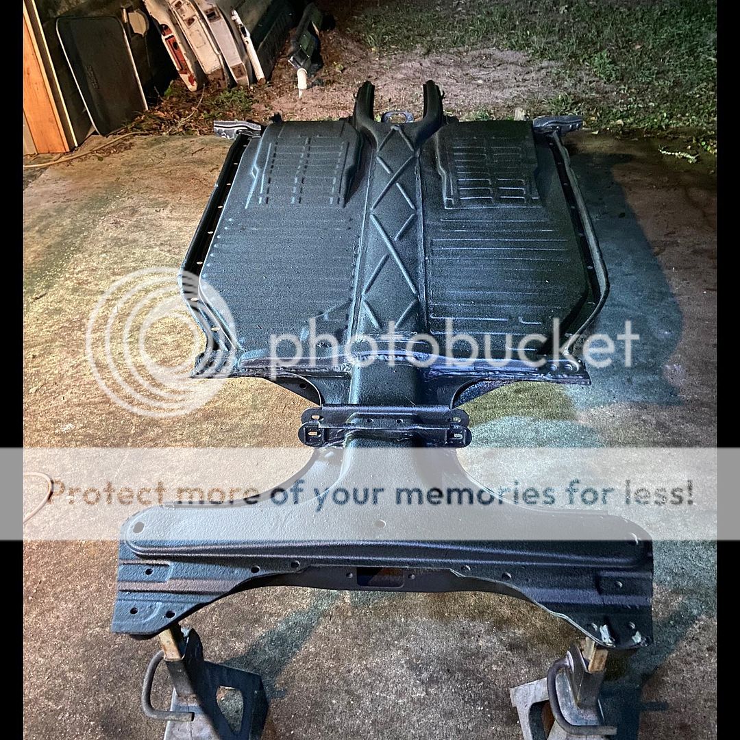

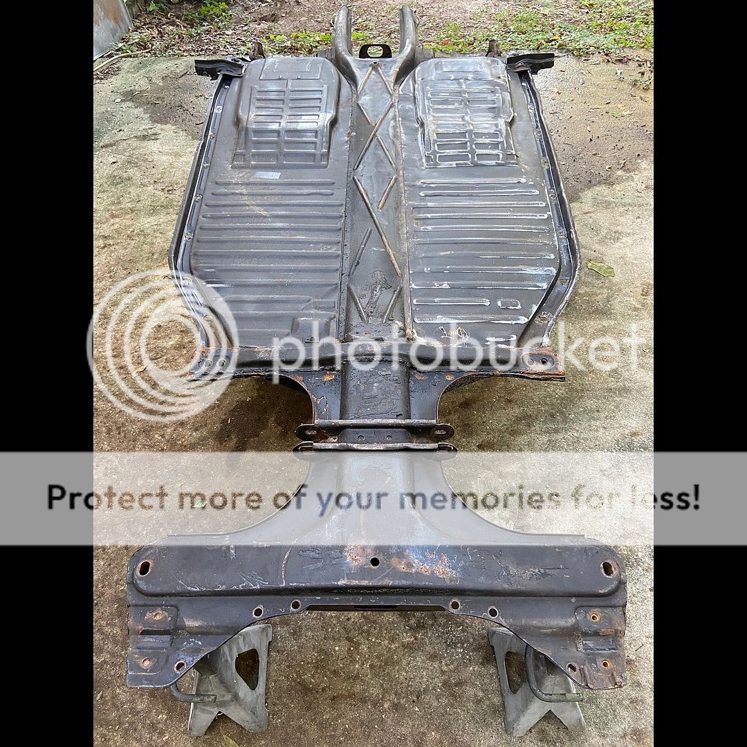

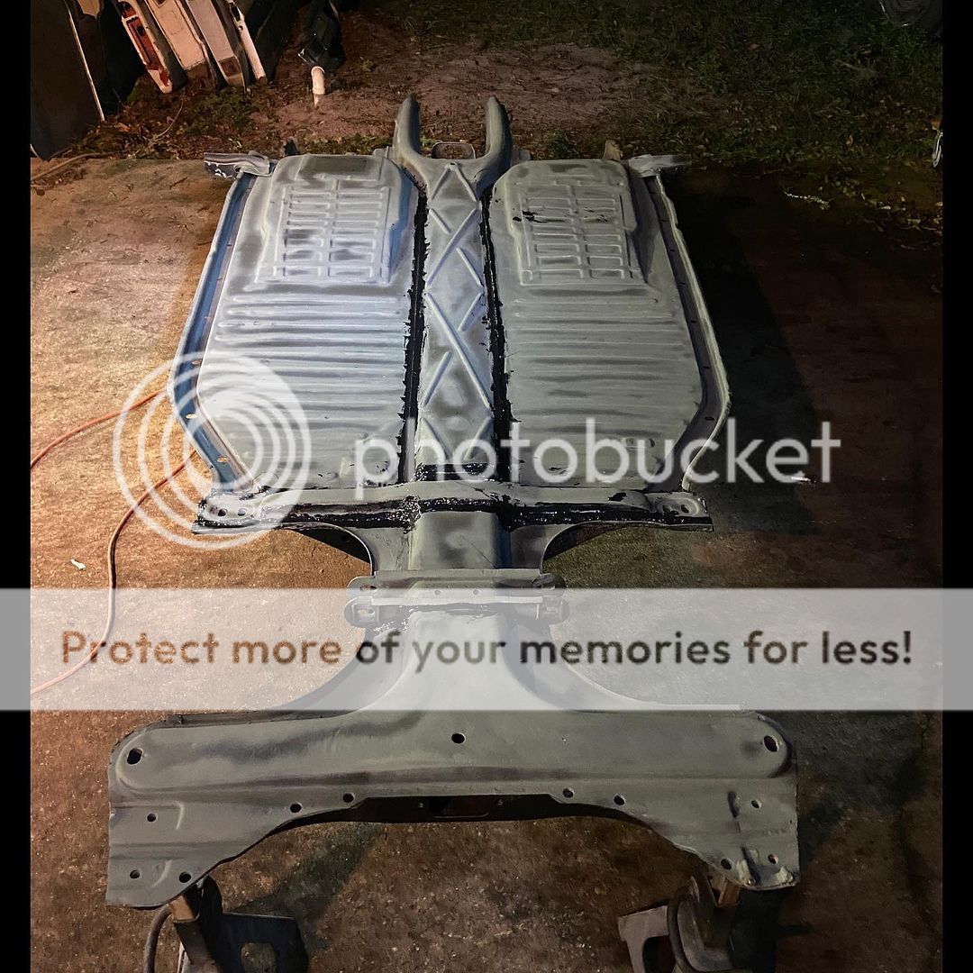

So starting around March 2020 started working on the pans. The pans had already been replaced but just like any car project the minute you start digging into the car you start finding rust and half assed work performed by owners from years past.
Upon separation of the pans from the body, with the help of my brother. I noticed the "napoleon hat" was pretty rotted out and needed replacing. We replaced the metal that needed replacement , stripped, prepped, seam sealed (Not the prettiest for sure, LOL) and painted the pans. The underside was also undercoated.

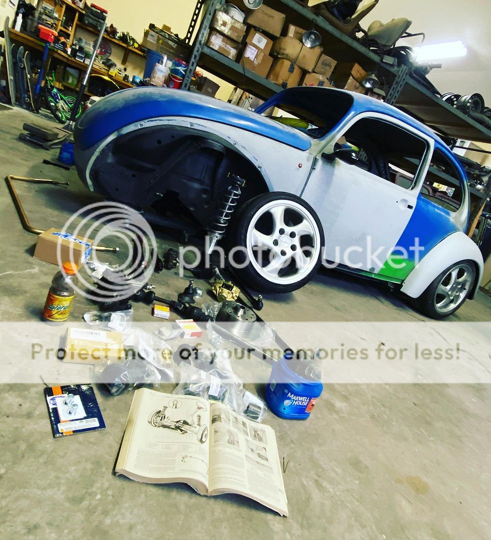

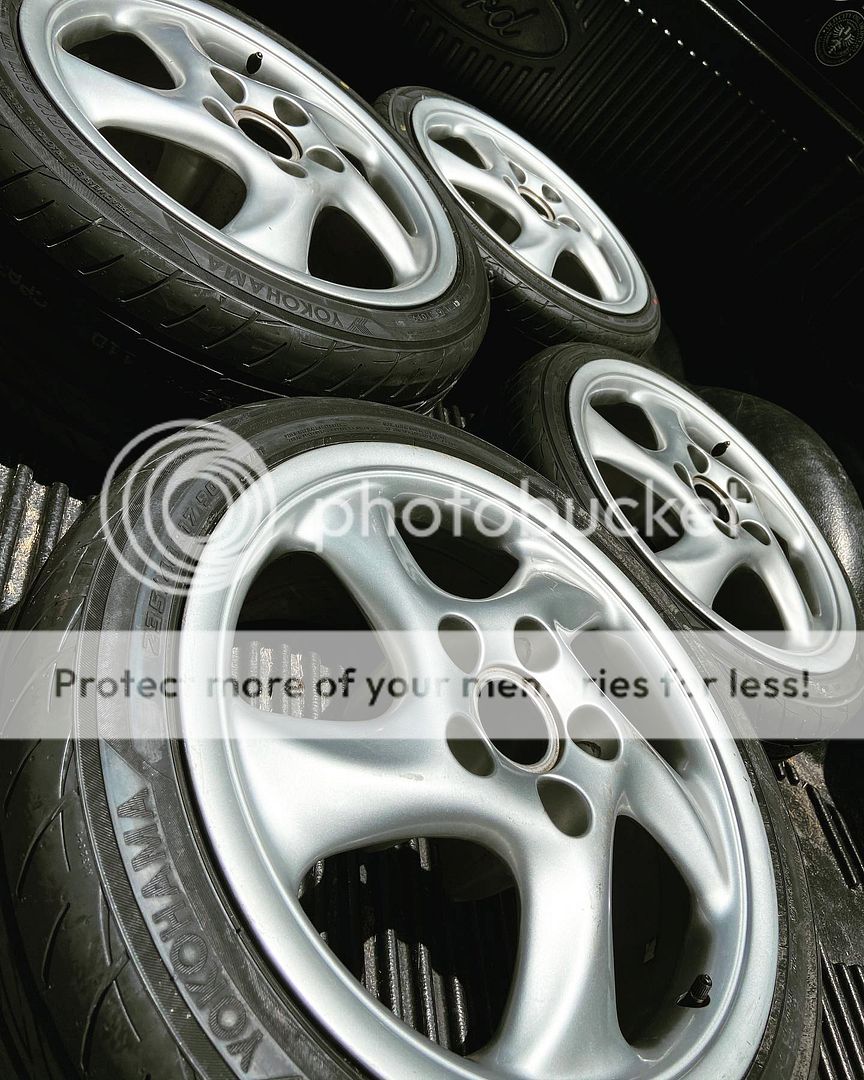

Once the pans were finished with their new coatings we attached the stock IRS rear arms and an EMPI disc brake kit (plans to change in the future to some 944 hardware) to the rear to check fitment of the Porsche 17x9.5 Twist Wheels(wearing 235/40-17 Yokohoma Advan Flevia Tires) to the pan.

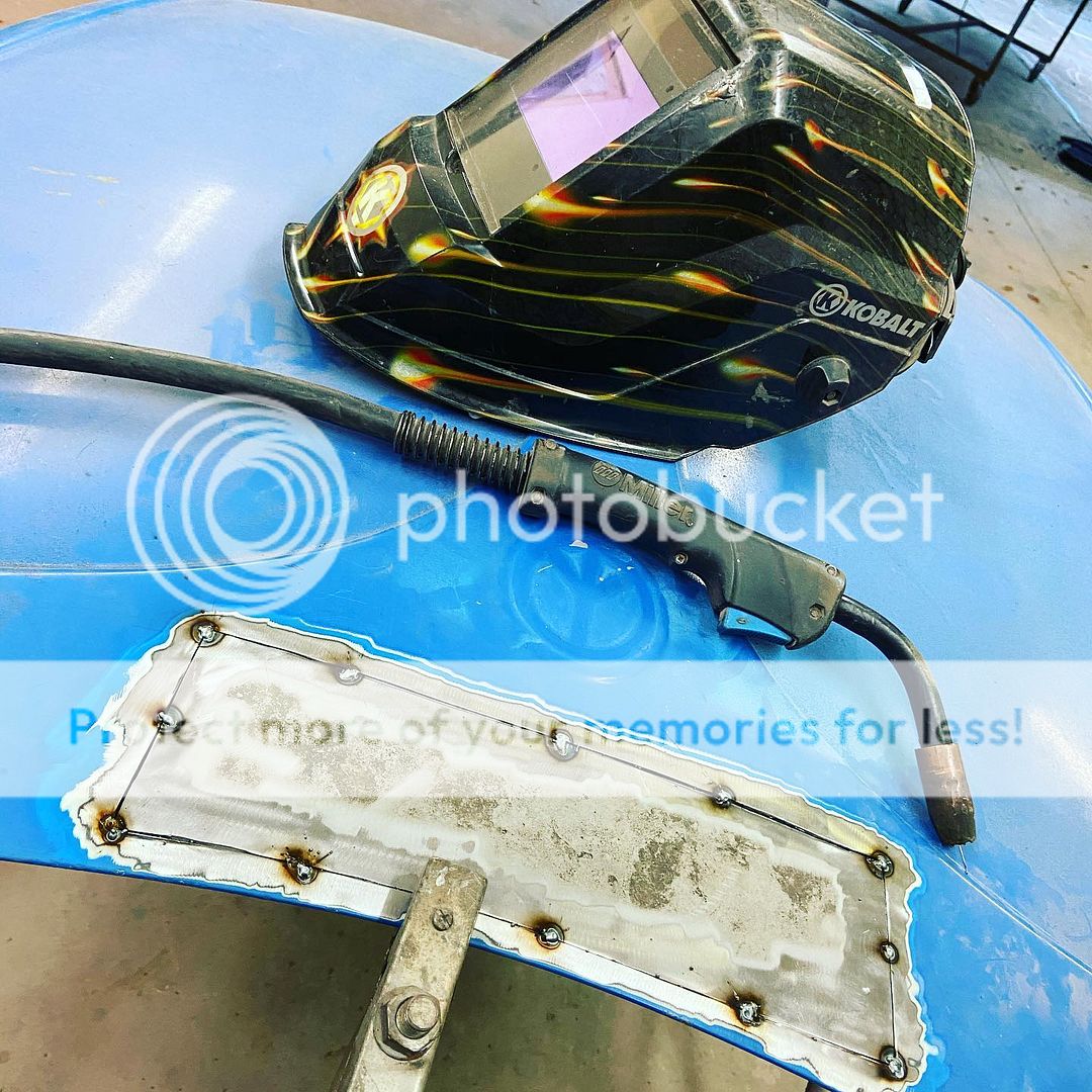

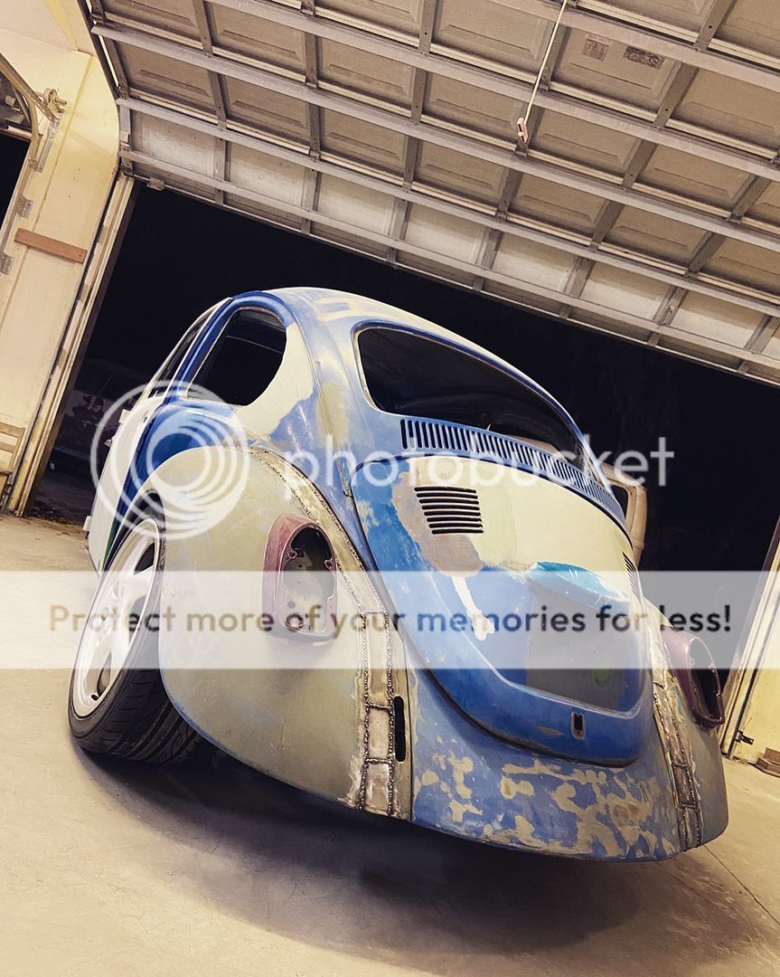

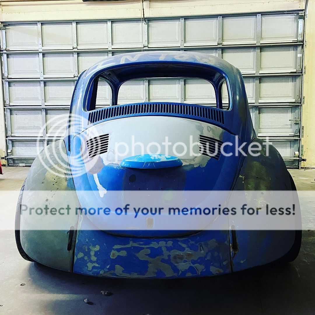

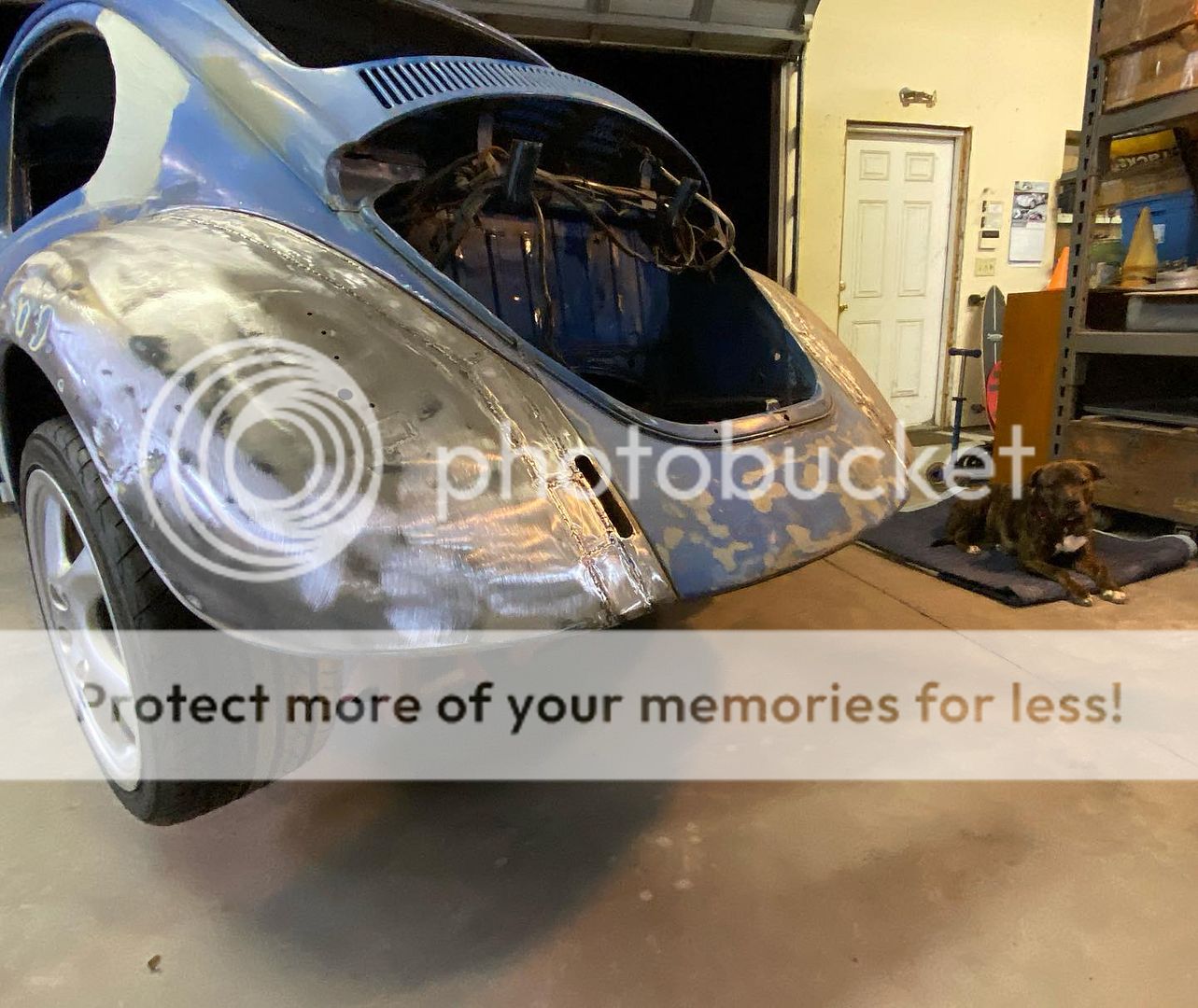

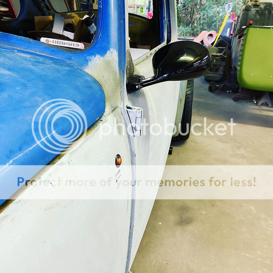

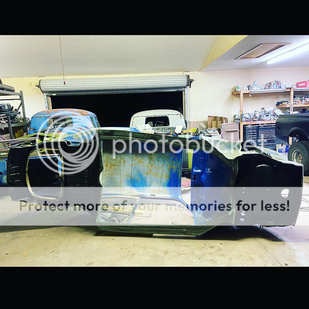

Updating the post a little with the past years progress. After completing the pans Cleaned the bottom of the body and undercoated, finally bolting the body on, started shaving some vents front and rear, shaving the half moons, antenna hole adding some mirrors side markers and widening the rear fenders 2 inches to accomodate the Porsche Twist 17x7.5 195/40-17 fronts and 17x9.5 235/40-17 rear

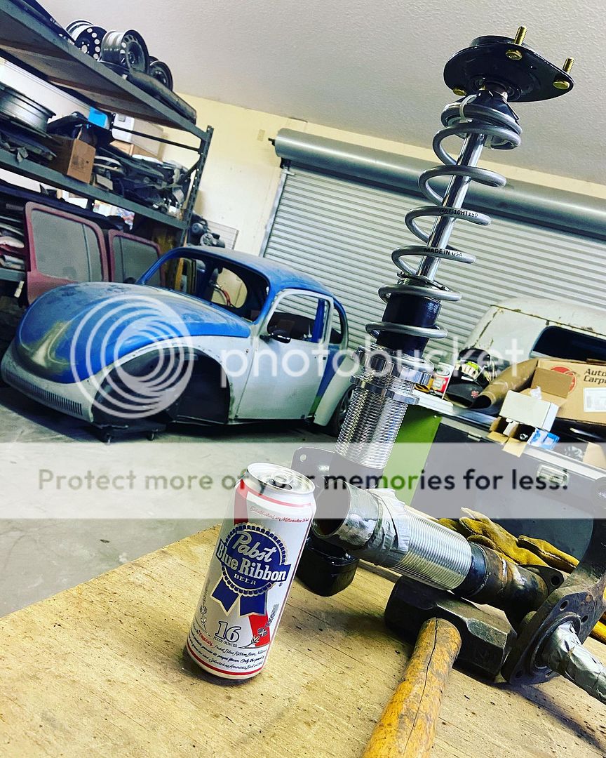

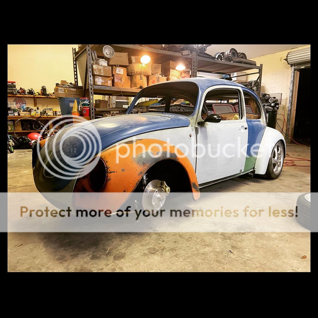

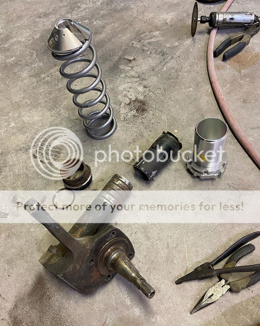

After coming up with the parts built a set of custom coil overs using QA1 springs, sleeves, a set of Adjust-s-strut lowering housings. At this time the front end was rebuilt with lowered swaybar, camber kit, flip kit, bushings, top mounts, new tie rods and basic empi 5x130 disc brake kit. Looking to upgrade later but at the time it was easier to locate this kit than get the 944 parts.
Old May 11th 2021, 20:56
flat flat is offline
Posts: 675
Nice front strut setup. What spring rate are you running?
Flat, Gonna try the 10 inch 150 lbs springs right now. If I need to adjust the spring rates the QA1 springs are so relatively cheap it would not be to difficult to change at a later date.
Old May 12th 2021, 12:29
Posts: 675
150# is probably spot on. I have 115# right now and want to get into 135-150 range. My car is a street car, family hauler so I'm not after track specs.

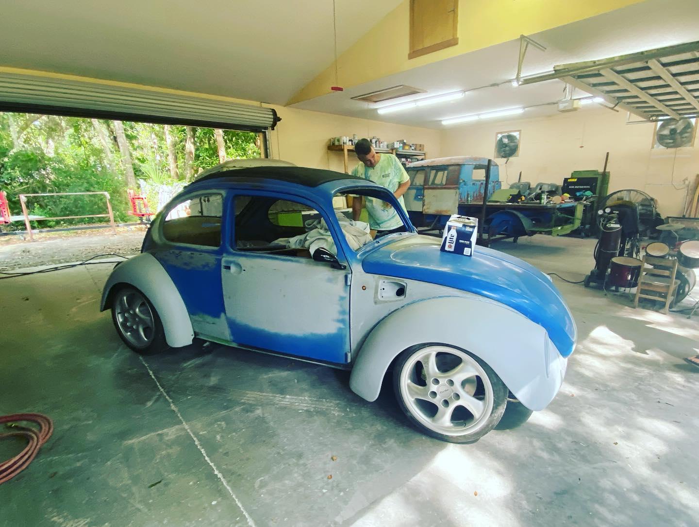

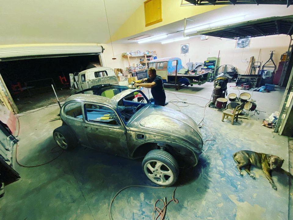

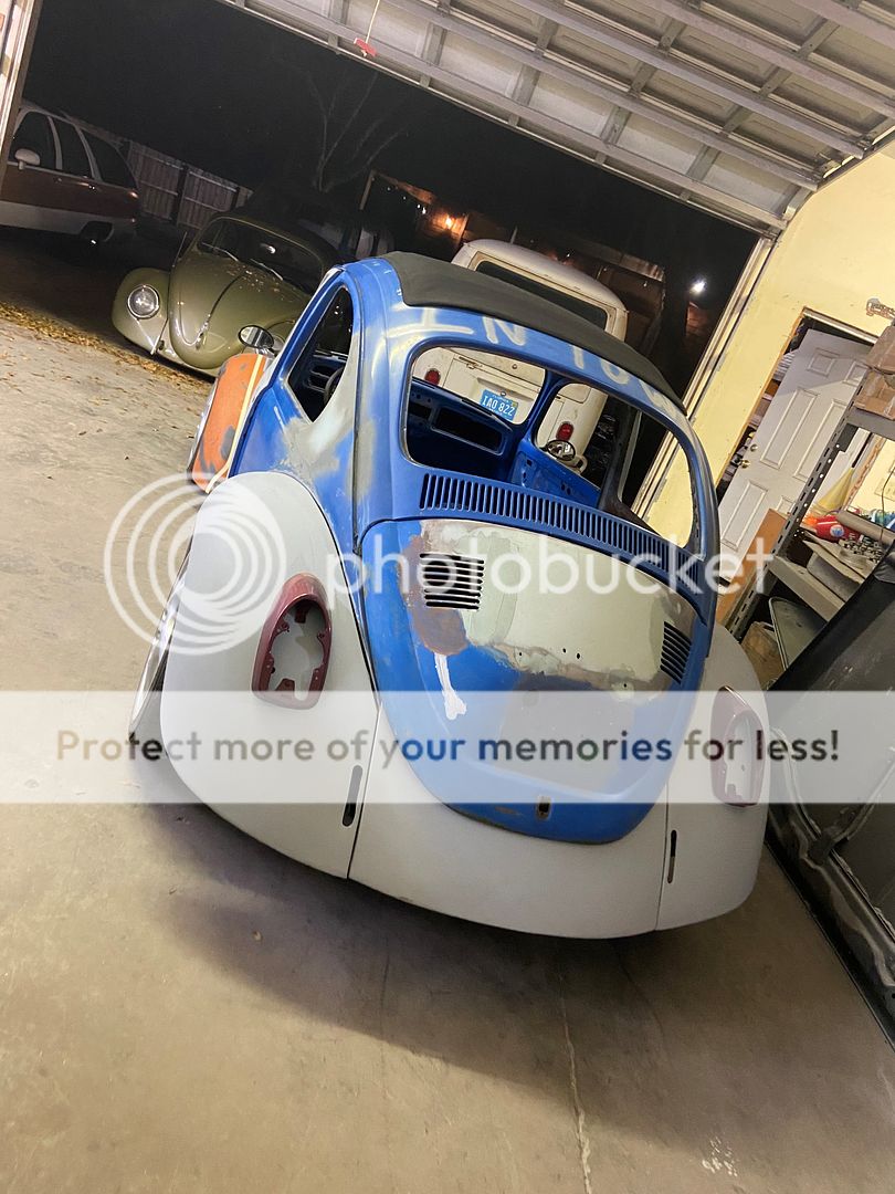

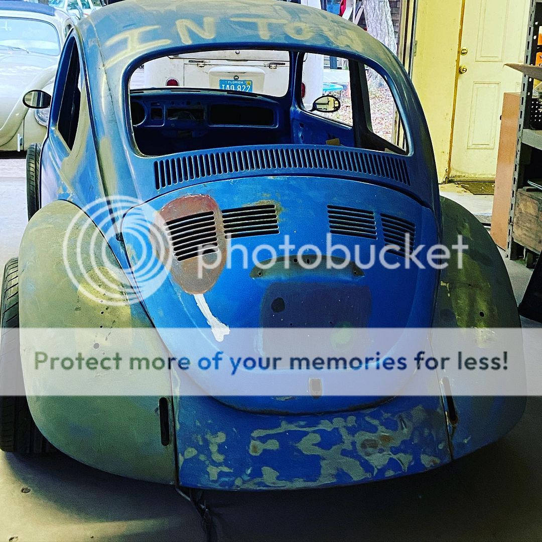

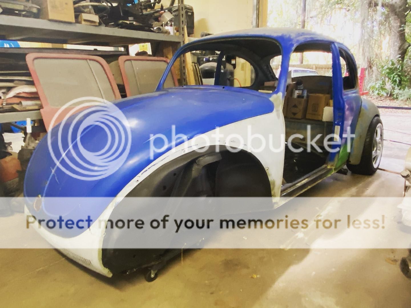

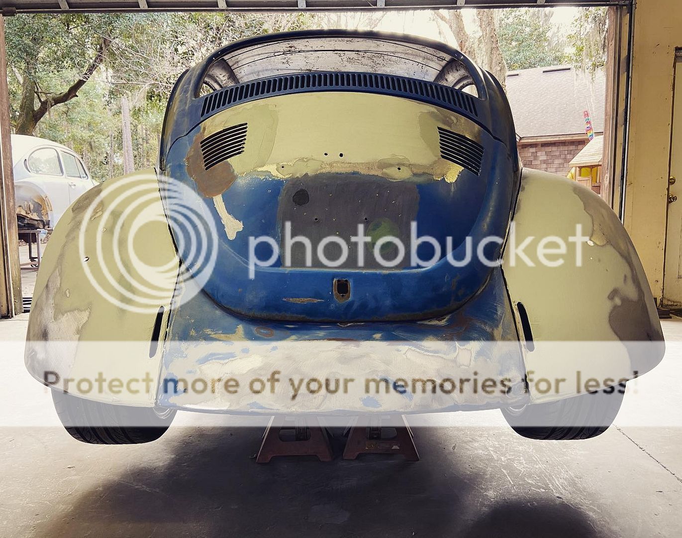

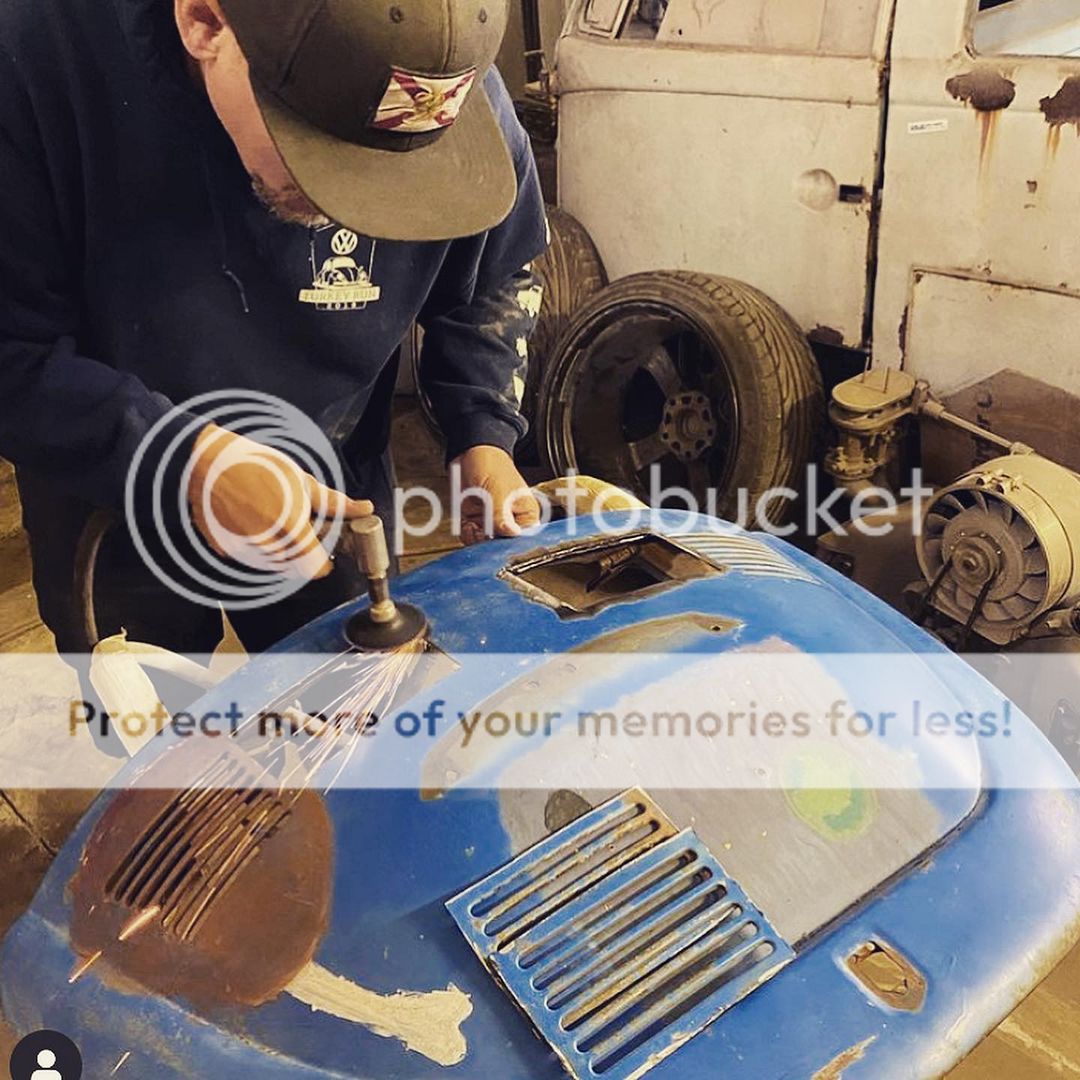

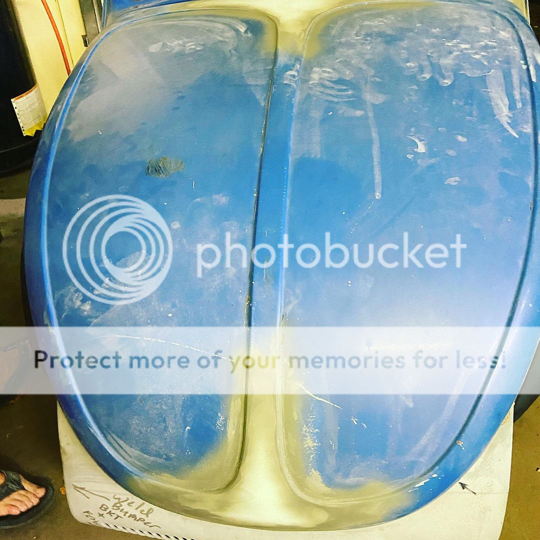

Small Update, Super Beetle Sunday Funday this weekend, Dissassembled fenders, mirrors, sidemarkers and ragtop from the car and started sanding the paint off the car. Progress is being made, body work to come next and paint soon. first two photos are what we started with and the wide view is right when we finished for the night.

How do you plan on getting enough cooling air into the motor compartment?
Stand-offs?
Old May 18th 2021, 11:00
The_Lone_Banana's Avatar
The_Lone_Banana The_Lone_Banana is offline
Join Date: May 2015
Location: Fernandina Beach, Floriduh USA
Posts: 9
Originally Posted by Clatter View Post
Right on!
A PBR 16 is always helpful during builds like this.
Thanks for posting up.
Stand-offs?
Clatter,
An ice cold PBR tallboy always helps with everything,
Thanks for checking out my post!
I'm not too worried about the motor compartment temps. Should be perfectly adequate. The other deck lid I was gonna run was a 68' solid lid, but chose to create more work for myself by modifying the 72 deck lid, lol. (I never have enough to do, all sarcasm implied) So if anything the two remaining vents on the rear lid should be fine.
The engine cooling comes mostly from using all and proper tins on the motor, so it really should be fine. The carbs getting cool air would be my only concern but that is minimal concern, the rear upper vent on the rear of the body should be enough to get fresh air and evacuate the hot air. If not, I'll cross that bridge when I get to it.
I'm running a 1600 based 1995cc dual port, ran beautifully with good temps in an older double cab and those did not have much better ventilation, living in Floriduh it definitely can get warm here. LOL

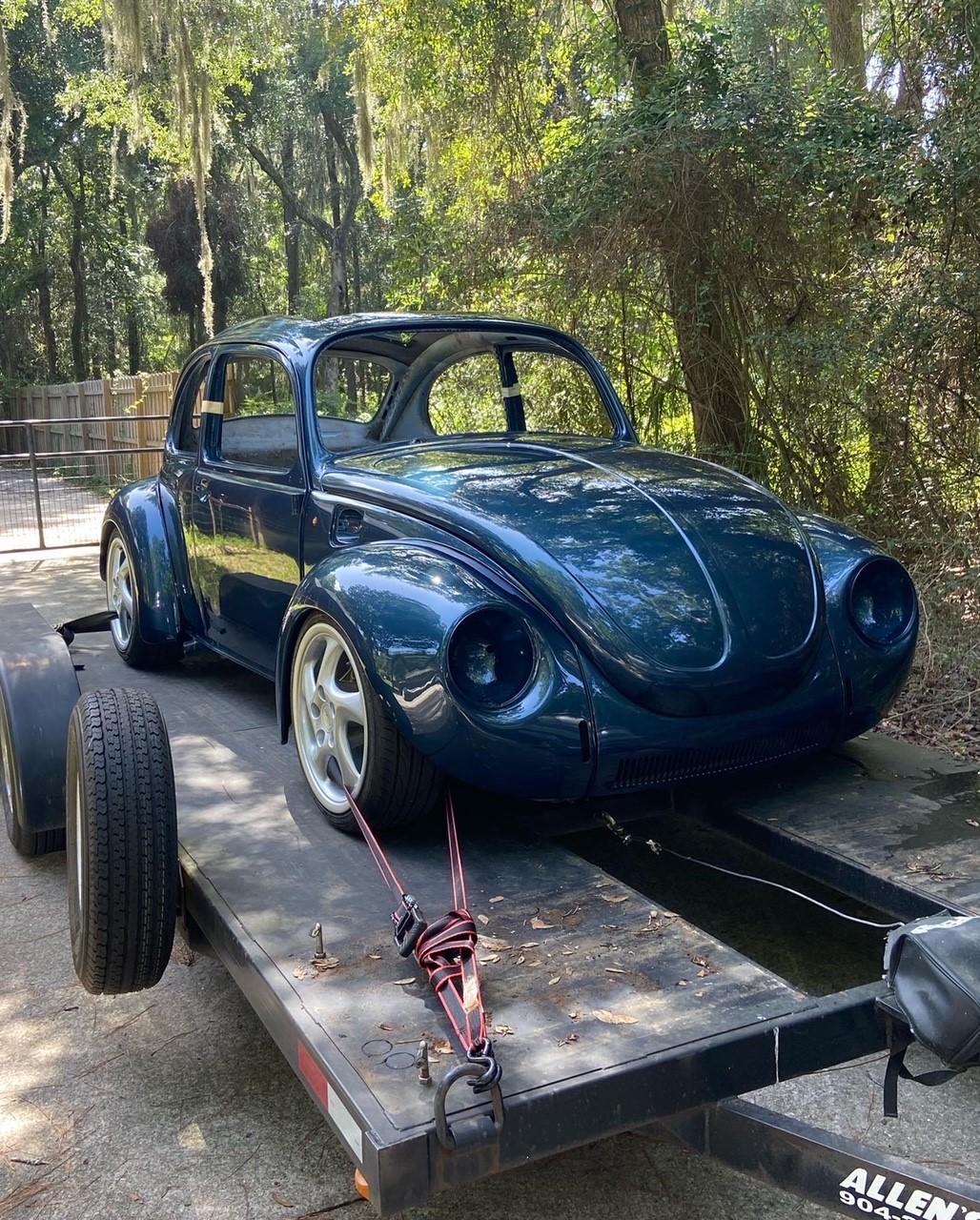

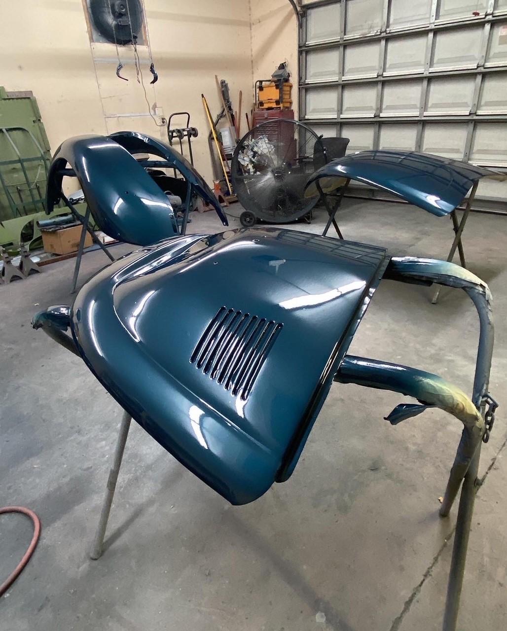

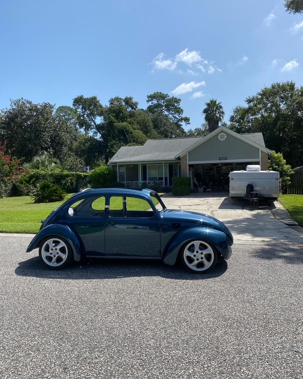

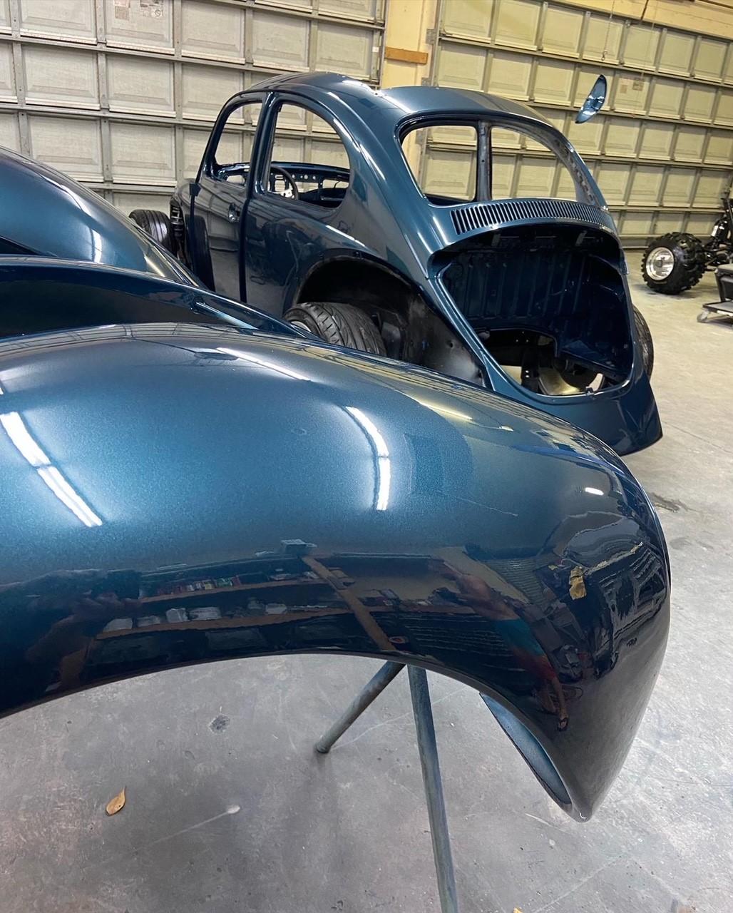

It has been a while since I posted on my car last. It has been a busy couple of months and I am going to skip ahead to where I am at currently. Bodywork has been completed and finally got the car into paint. Currently I have been assembling as I have time or when certain parts come in. Here it is as it sits now. 7 years owning this car and the past 2 years in my buddy's shop my car has finally come home for reassembly. Still alot to accomplish and purchase but I am happy with the outcome so far. Hope you enjoy. Let me know what you think so far.

Nice!
A proud day in a man's life bringing a fresh shell home from the painter's...
Gonna get more and more fun from here.
Old October 5th 2022, 01:59
Join Date: Jan 2018
Location: the Netherlands
Posts: 37
That color looks super!
