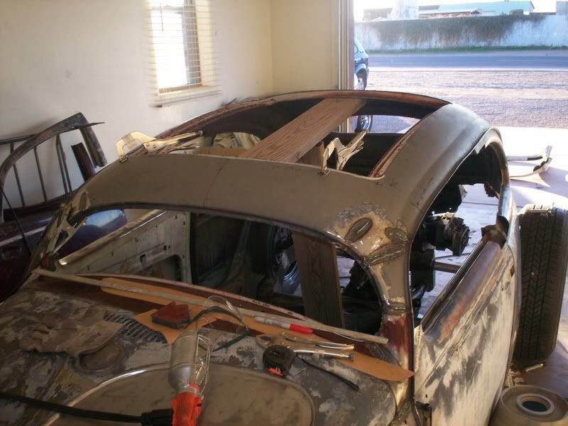

So i have this OTHER project that has been on hold, pretty much since i acquired my 65 bus. i WAS building a volksrod, but after starting the GL bus build, and having an extra set of Porsche brakes laying around, i decided to build somewhat of an F-1 inspired car. It will have a mid-mounted supercharged VR6 mated to a 914 901 5 speed trans. Full tube chassis with coilover/a-arm front suspension and 944 aluminum trailing arms with coilovers in the rear.
i got this silly mid-engine idea after drooling over the "UBRDUB" that volkdent is workin on.
Here are a couple pics of the car i was building.
http://i4.photobucket.com/albums/y13...9.jpg~original

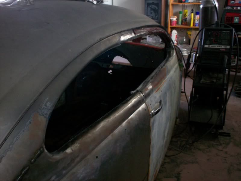

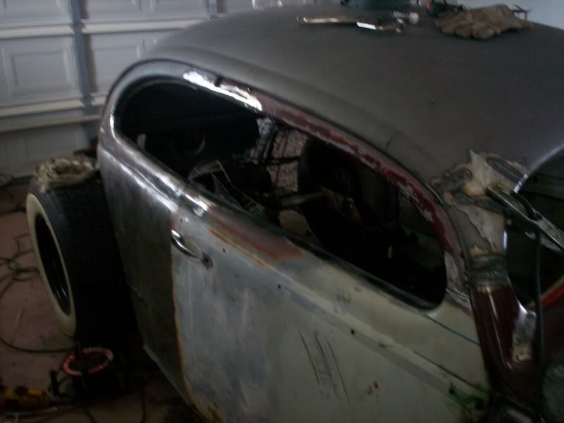

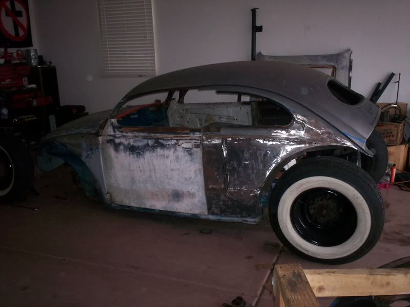

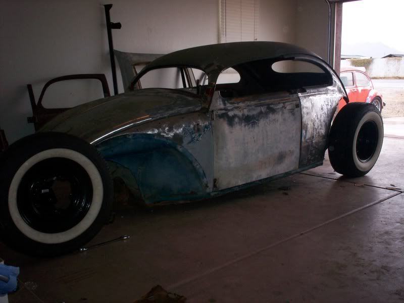

Chopped the top 5.5" in the front and about 3.5" in the rear. i think it came out decent for my first chop.
http://i4.photobucket.com/albums/y13...0.jpg~original
http://i4.photobucket.com/albums/y13...1.jpg~original

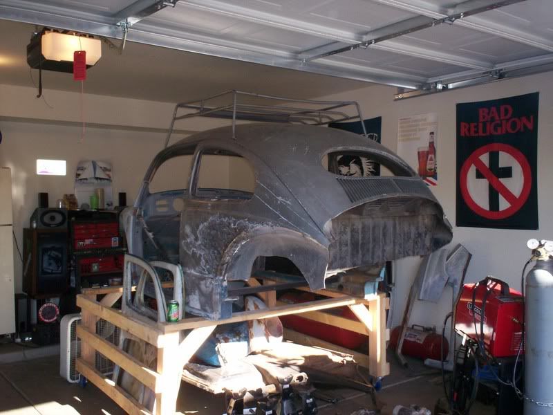

Puttin a big hole in the roof.

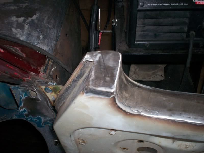

Capped the doors, since it will have no B pillar and therefore no side glass.
And thats pretty much where it sits at this point. i have acquired a pretty nice original W declid that i will be routing the exhaust through, and have ditched the whitewalls, because i want to put a set of 18" or 19" Hollow spoke Porsche wheels on it. Like these:

volkdent September 21st 2010 13:14
Love the B-Pillar removal, something I've been thinking about for over 10 years. Great look. I actually want to paint out my B-Pillar in black to give it a similar effect. Should look really mean and be a serious head turner!

volkdent December 27th 2011 19:07
I don't know why I didn't catch this before, but I'm quite sure you can't go mid-engine and use the Porsche ally arms, no room between them for engine and tranny:o Sorry to burst your bubble, but i know you'll figure something else out!
hotsauce December 27th 2011 20:37
Yeah I kinda figured that after thinking about it. So we're going to do full a-arm suspension and I'm going to use the aluminum arms on my bus once I find a Porsche box for it. Thanks for the input!
