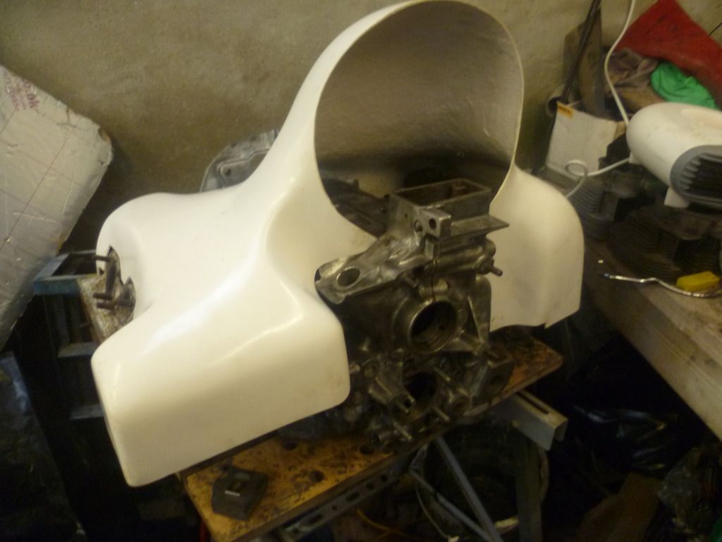

what make porsche cooling
what make is this, it covers the stock oil cooler, and what's the cooling like.

Cooling on that wouldn't be terribly effective, there is no internal vanes to direct the airflow around and air doesn't like making 180degree turns on it's own so very little air flow would go through the oil cooler.
Sharpbuilt here in Aus makes one that uses the same style oil cooler ducting as Porsche.
Taking air from directly against the fan then ducting it around to the oil cooler
