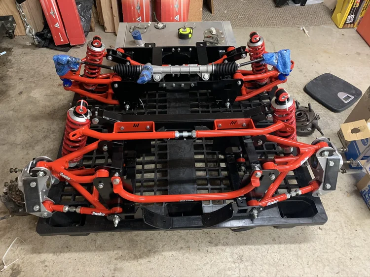

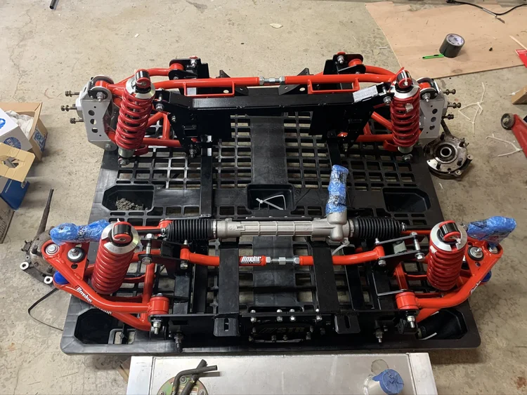

Let see if this works. This is the front and rear, unpackaged but still on the shipping pallet.
You'll also peek at my fuel tank, and the parts I'm pulling together to build out the rest of the rear setup.
I've also got an alternate steering setup that might get used which is an inverted Subaru STI JDM RHD Power Steering rack - which I might use as I'm running an STI engine which has the PS pump on it just need custom PS lines - for now I'll stick with what they included.
And here is a full gallery on my personal site of the unboxing / detailed photos of the parts so you can have a peak. They are raw and some or mis-oriented but you can tilt your head easily enough to see the details.

Thank you for posting these!
And after going through your photos, I now understand what some of my friends who had seen them in person were talking about:
Here's the thing, those welds aren't necessarily "bad", but I would be tempted to sandblast the parts to confirm them. I talked it over with a fabricating buddy of mine when I was considering ordering the full front/rear setup (before I bought the red car) and we agreed that we can't reverse engineer the setup for less than they are charging. Even if we have to re-make a couple of their parts, we are far better off both economically and time wise.

Yes, owdlvr - Agree those are my only questions and will have them blasted when I do my chassis. I have a local race shop that I'd have re-tig / reinforce these parts for me if that's required. For the price, it was totally worth giving it a shot. I've also put a deposit on their "Full track" version of all the a-arms (just the arms/hardware) with all rose/heim joints and hardware but will start with this setup as is for the start of my build.
