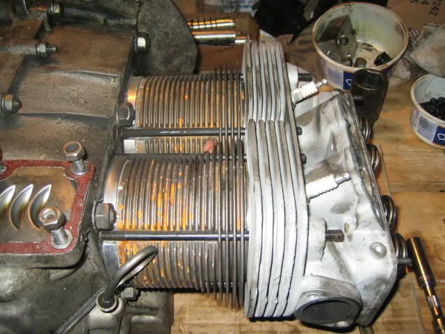

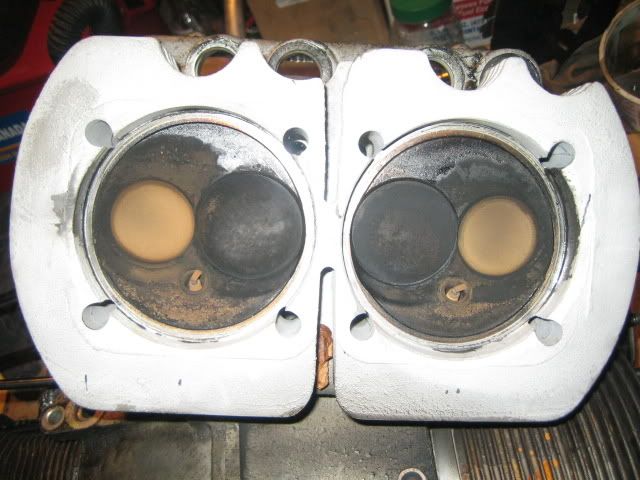

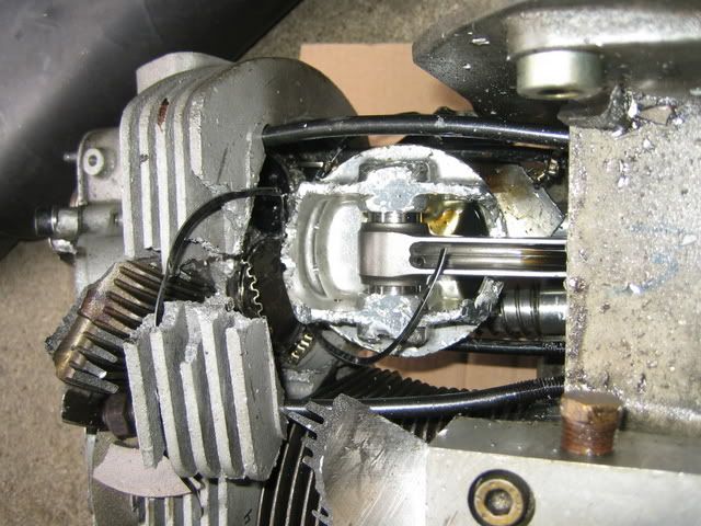

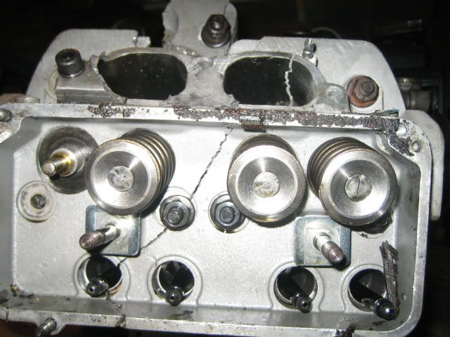

Not working today, so i tore down the 2332, that was pulled a couple weeks back, which blew in Dec. Here's what i found,

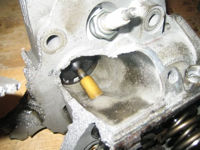

The exhaust valve had no face, and the tip was ripped off at the keeper:

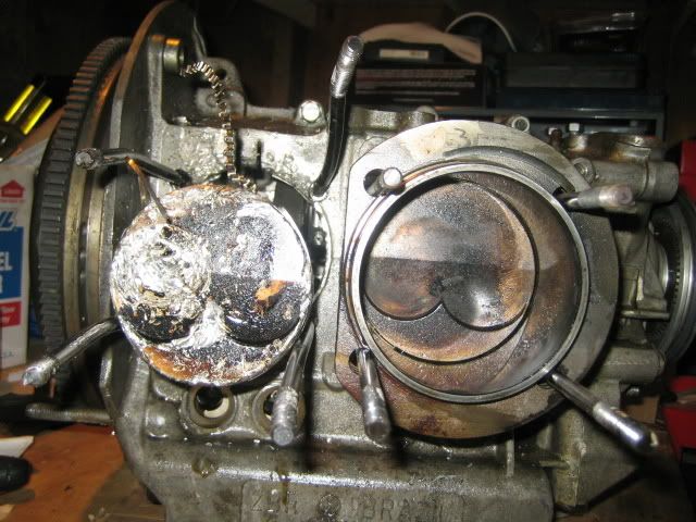

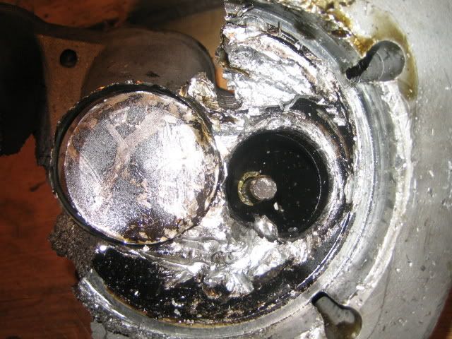

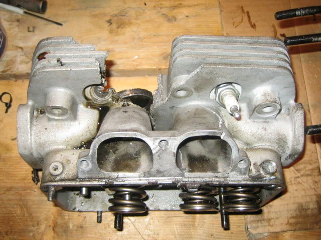

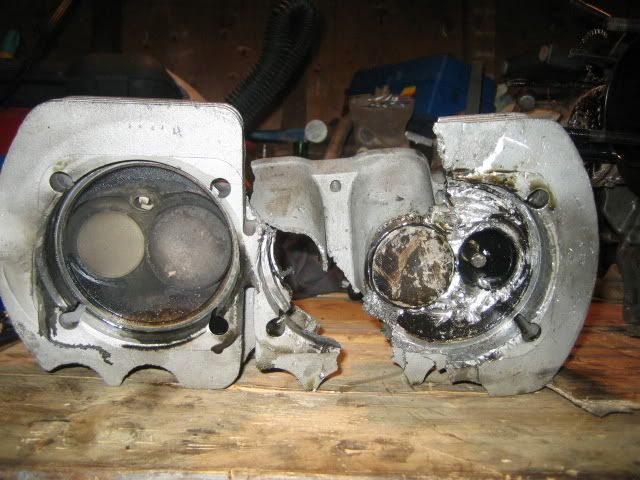

Head split in 2. Thinking the barrel split, and the piston went sideways smashing into it:

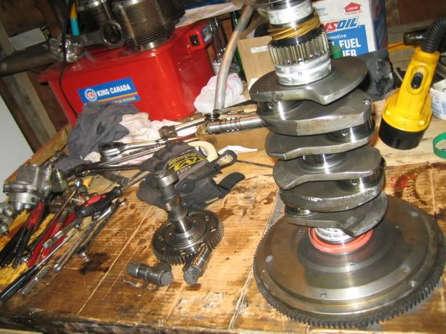

Wiseco piston/pin rods stayed in one piece:
86C broke in 3:

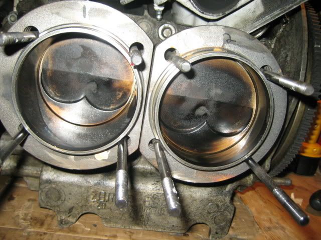

The other side (1&2) looked good:
So, the stocker 1600dp is going back in for the summer. Need to finish the other 2332 that is sitting on the stand. ;D
I'll get the rods/crank looked at and serviced next week. Part it all out. Hopefully i can get some cash at the local swap meet next weekend (John's Bug Shop).

Wow that's one huge lost, is the crank still good. Those inlet valves aren't unshrouded at all.
