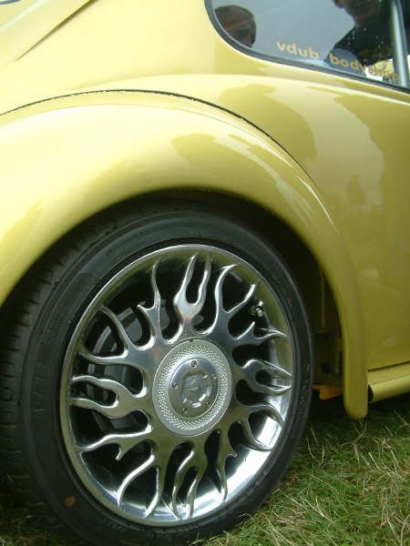

Theses are the rims....... which I'm not changing!

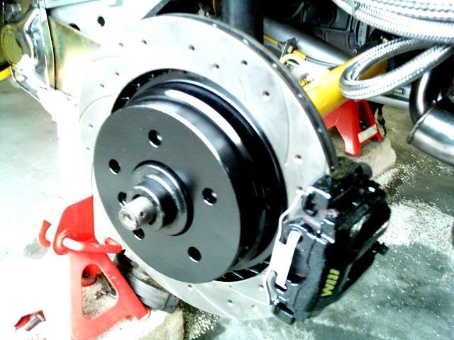

how did you attach the rotors? did you use porsche hubs?
thanks
rip
Nope, I made my own hubs up out of the bug discs and drums. (they were blank THICK items that were already drilled to BMW stud pattern)
The rear drum was turned down so that the disc fitted over it, 'Top Hat' style. Then bolted to the hub with countersunk screws and a bottle of threadlock!
heres the rear hub,

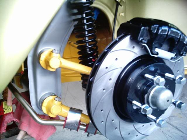

With the fronts I again turned down the bug discs to make a similar hub, but instead of fixing the disc ofvr the top I attatched it to the back again using the 5 screw method, you can see it better in the pic...
