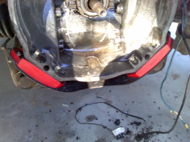

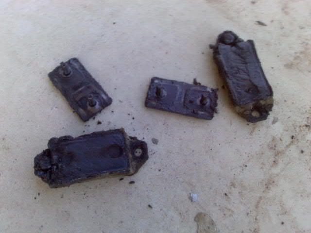

Ive had to take the engine out to fix the rear main oil seal and replace the fly wheel o ring. I thought that this would be a good oppertunity to replace the suspect engine mounts.
yeah it looked like they needed to be replaced to.
I think the technical term was engine rests.
Red New parts just look great!
