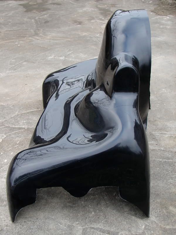

As promised- pisc of the klaus shroud of the 3rd generation. Note the complex shape on the back plus the mentioned internal air distributor. Sure some development went into this. The shroud uses a smaller porsche turbo like fan. 225/250mm diameter.

Old January 21st 2008, 07:29
Bad bug's Avatar
Bad bug Bad bug is offline
Join Date: Mar 2003
Location: Jamaica
Posts: 310
Eugene does you fan ring carry this code 901 106 101 5r on the fan ring. Why i am asking is because i think i have a turbo 911 fan and i am not sure. Also i need to change the fan it has some of the blades with cracks in them.
  #96
Old January 21st 2008, 07:44
eugene eugene is offline
Join Date: Oct 2007
Location: Slovenia
Posts: 4
The ring is not an porsche item. Is made by Klaus so no OEM numbers. The outer diameter (250mm) is smaller than the turbo unit. I think the 11 blade fans are ok to be turned down to a smaller dia. and the twisted- end 12 blade are not because of drastic loss of air flow. I think GWD uses a turned down 12 blade fan(240mm). If you are planing to turn down a original porsche fan, you must buy a smaller ring from a tuner and have the fan rebalanced afterwards. I think it works this way.
