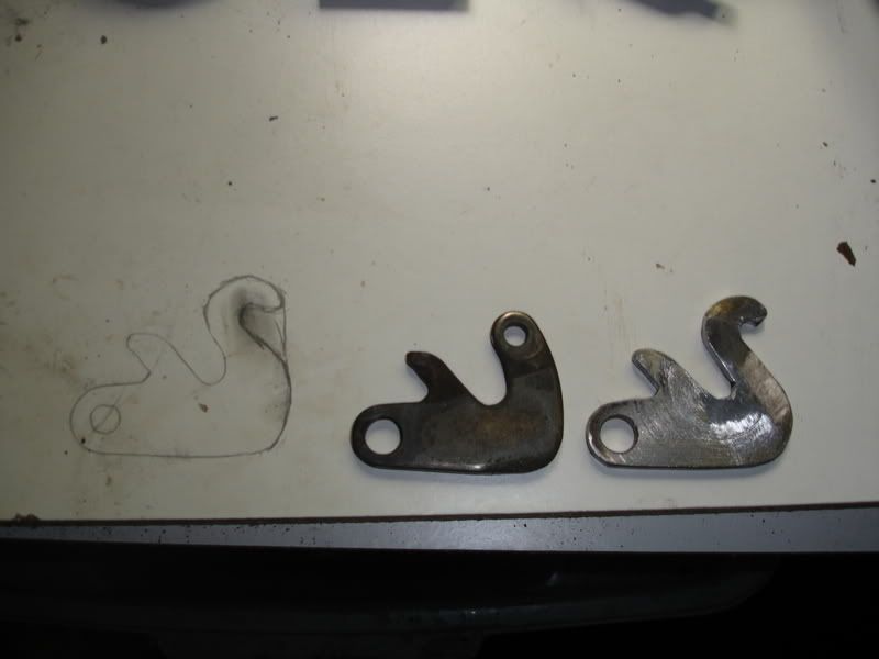

I just did this last week .. in the brake gallery you will see what a 944 stock end thingy looks like. Its the peice that has a hole in it and connects to the brake shoes.
I built up the end with a welder and then used a dremel to notch it for the stock beetle brake end. The way it is notched, there is no way for the beetle end to come off. It looks somewhat like a 'swan' ...
I then bought some spacers from Alex to take up the slack in the cable where it enters the 944 ebrake assembly. I could have shortened the stock 944 brake tube with the welber but the price was right for the parts.

I reread your post several times and tried to check the photos in the gallery but I just dont seem to understand what you really did...
I would love to get some more info about this..
(I know it is an old post but the tech info is good, just need to understand it too... )

swans
Hi,It will look somthing like this:
You can buy them from vdub engineering if you dont want the hassle.

Thanks! That cleared it up for me. I went through my parts yesterday and I saw the 944 parts too so all I need to do is to mod them.

Do you have any diameters of it? I can make AutoCAD file and publish it

Im living in Europe and shipping from USA will cost more than parts :/
I can cut it on my CNC
Best Regards
