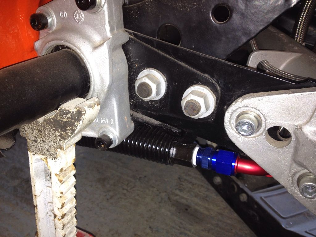

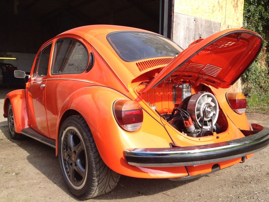

will ive made a bit more progress on the bug and is ALMOST ready to MOT......but the bug obviously wants to stay off the road a little longer.....
all the oil/fuel and breather lines are done - just need tidying
just need shocks now and engine setting up by RNJ Morotsport.......however the bug spat its dummy out last week
the new hydraulic clutch set up (although is now 4 years old as the project has been going on for so long!) decided to ditch all the the fluid inside the tunnel of the chassis ive flushes the tunnel as best i can and looks to have got away with minimal paint damage. I took the cylinder out (which it turns out i can only JUST manage with the body on!) and is scored.....so have ordered a new updated kit from saco performance.....which will be with me in 2 weeks!
soo now its just clutch and shocks.........
lets hope its ready for spa!!!

Looks awesome! Question: What axles did you use with the aluminum trailing arms?

I will definitely be at spa, hopefully in the bug but if not, il be in my 70 bay. Il keep an eye out for you wally!
Axles are 944 items to match the arms

Posts: 225
Dean, did you just get the MC from Saco or a rebuild kit?
I keep looking at alternatives to the Saco for in the tunnel and they are not too common. BMW 3 series or one from CBSonline are my current choices. And if you don't mind me asking how much was it with post and tax?
