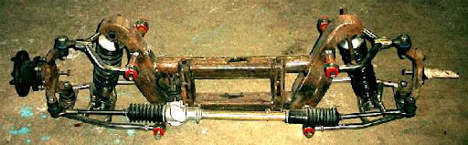

Guys.. anyone did a comparison between the two?
I am really impressed by what Bruce & the guys are doing over at Eyeball..
Their narrowed version (i think) will be useful for those who wanna stay with the stock fenders.. They cost $3,000 without spindles or brakes... no coilovers too i think. Not necessary a bad thing since one can use whatever they desire accordingly to their individual need.
However I am quite bummed about the obvious lack of a front sway bar..
Mendeola A-arm includes the lot at just under $4,000. Hmmm...
With my limited knowledge on suspension/steering geometry, I have no insight on any technical comparison.. Anyone?

Mendeola would win hands down for me, I really don't like using steering arm ball joints for wishbone joints, I've had bad experiences of this before...

I'm with ricola, The eyeball kit is overpriced and has a lot of slop built in by using ball joints. I'd be afraid to track that setup or even drive it home. The mendeola I've had eyes on since it was in hot vw's. I've been thinking of another fun project with a friend and it would probably get the mendeola front. It's just built right, double shear, sway bar mounts, and is compatible with super beetle pan heads.

I agree with Humble and Rich. Eyeballs goes some way there but on that arrangement I would use rod ends for ultimate adjustability. On both of them the arms could be longer given that its almost a clean sheet of paper. Mendeola's arms appear even shorter so the camber change will be harder to control in roll. If you are going to fit a double wishbone front why not go the whole hog and use very long arms with maybe bell cranks and monoshock? Or is that too radical?

I'm not totally thrilled with either, if I could I'd take the sway bar, structure, and some of the design of the Mendeola and mix it will the bolt on of the Eye-Ball. I spoke with the guys from Mendeola about this a long time ago, but they insisted it couldn't be made to bolt on, I don't think they tried hard enough. I suspect a version 2.0 or 3.0 out of Mendeola will be the hot ticket.

I think the latest version is mostly bolt-on with a little bit of welding for strength
