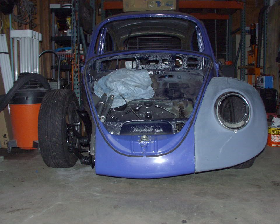

Got the new front suspension under my project `69:
Front:
Avis adjustable powdercoated beam
CB drop spindles and disc brakes
Stock height KYB GR2's
2-1/2" wider than stock CCC early style(`66/`67-down) fenders
Rossi headlights
8mm spacers
modified dust caps
modified speedometer cable
16x6" ET50 wheels with 205/55's
Only substancial difference is in the picture it's got 15x5.5" ET40 rims with 195/60's - which actually have 3.65mm more frontspace than the 16x6's.
http://photobucket.com/albums/v212/KaferCh...s/Project%2069/
