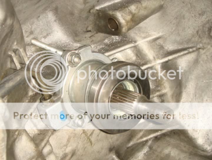

hmmm... Presumably we have the same TOB here Luis?...
Pic from SteveC on Aussie Veedubbers
There is also a thread on Volkszone about this...
And pics of what I've just had delivered. Best pics of the dimensions that I can get as I don't have the micrometer down with me. Note that this one doesn't have a sleeve around it, because its a cheap most likely, but if you are willing to pay the money you can get them with the bellows.

Nice pix Al, do you know what thats off?
Do the mounting holes match the VW sleeve holes?
I guess you will tell more once you have had a look at a gearbox

After studying you pix a little closer I see GM on there, whats the number stamped on it?
Part number GM 90 523 765.
Height 63mm
Height pressed 52mm (Correct 39mm)
Width 67mm
Base center center screw 63mm
I'm work on new adapter base to this solution, you see on the laptop. (center up lap. display)
